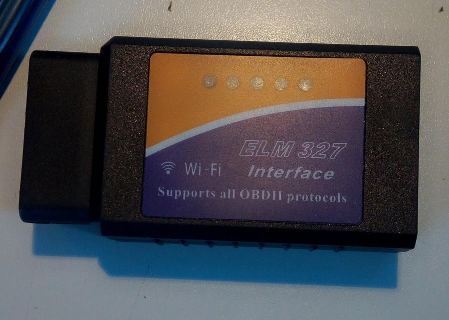

Stiti de vreo aplicatie pentru Android compatibilă cu cablu VAG-COM? Nu am pretenția să aibe toate functiile VCDS, dar ar fi frumos sa pot sa fac un scan rapid si eventual vizualizare live a parametrilor motorului in mers.
UIte iti iei o jucarica dinasta, ELM 327, instalezi pe telefon ( android) TORQUE ( LITE ) si ai un minivag ce se leaga cu wifi sau bluetooth care iti arata o multime de date, si ce-i mai important citeste ceva erori pe care le si sterge. Exact ce spui ca vrei tu ...
dar atentie, doar pe Motor cu ELM327.. si limitat la erorile si functiile standard ale EOBD 2
bineinteles

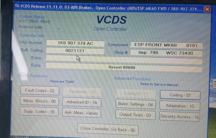

Am incercat sa codez cu 0021121 , am făcut testul cu volanul și manevrele respective și nimic ...

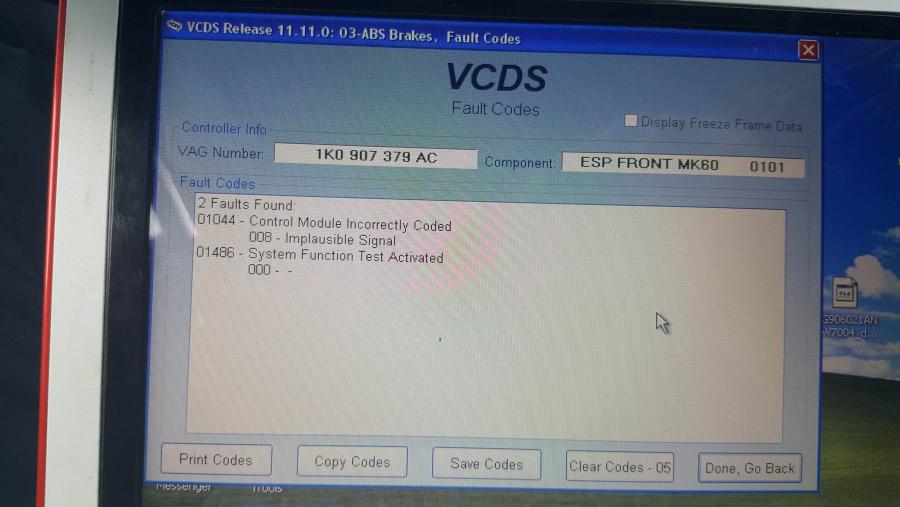

Prerequisites
The ONLY fault that should be stored in the 03-ABS controller is 01486 and the 44-Steering Assist module should be fault-free.
VCDS should NOT need to be connected while performing the Function Test!
Vehicle stationary
Ignition ON, Engine ON (Running)
Perform the Test Drive on an enclosed Site (i.e. a Parking Lot)
Make sure to Complete the Function Test within 50 Seconds after pressing the Brake Pedal
Instructions
Firmly press the Brake Pedal until a certain Brake Pressure (usually right above 30 bar) is reached.
Brake Pressure Sensor (G201) Plausibility will be confirmed by a Change in the Brake Electronics Warning Lights.
On Bosch, the ASR/ESP Warning Light (K155) will switch OFF and the ABS Warning Light (K47) will switch ON.
On Continental/Teves, the ABS Warning Light (K47) will switch OFF and the ASR/ESP Warning Light (K155) switch ON.
Start Driving straight with a steady Speed of ~20 km/h (~13 mph).
Turn the Steering Wheel either Left or Right between a 90° Angle (1/4 Turn) to 180° Angle (1/2 Turn) and keep it steady.
Lateral Acceleration Sensor (G200) and Rotation Rate Sensor (G202) Plausibility is confirmed
once the remaining Brake Electronics Warning Light(s) switch OFF.
The Function Test is now completed.

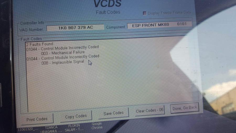

Hmmm, nu reușec să fac codarea corect, pentru că nu scap de eroarea 01044.
Am nevoie de codul corect de login și coding :( .
Ai idee cum le aflu ?

nu ai nevoie de cod de login si nici de codding. Ai o scanare anterioara ?
Si cum ai ajuns in aceasta situatie ?

codarea ta actuala este pentru o masina 4x4.
codarea corecta este 0023170
Modificat de Al Bundy
@Al Bundy , poti sa imi spui , te rog , cum ai ajuns la acest calcul ? Din toate incercarile mele de pana acum nu mi-a dat niciodata 0023170.
Multumesc mult.

Am încercat cu ambele ( 0023170, 0021126 ) , sunt acceptate dar nu schimba cu nimic datele problemei.

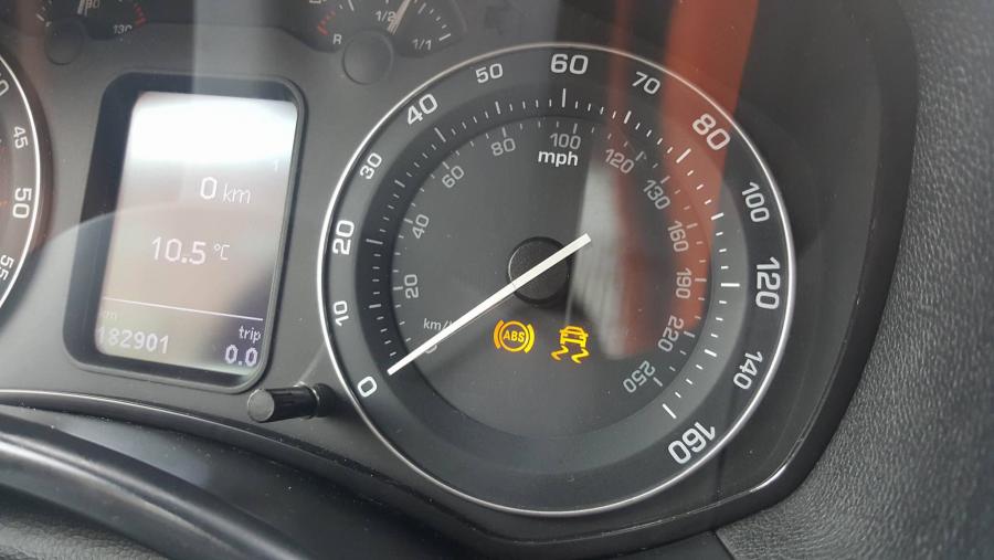

Îmi cer scuze am omis , s-au schimbat ceasurile in bord și atunci s-a pierdut codarea la abs , nu reușesc sub nicio formă să rezolv cumva problema :(
