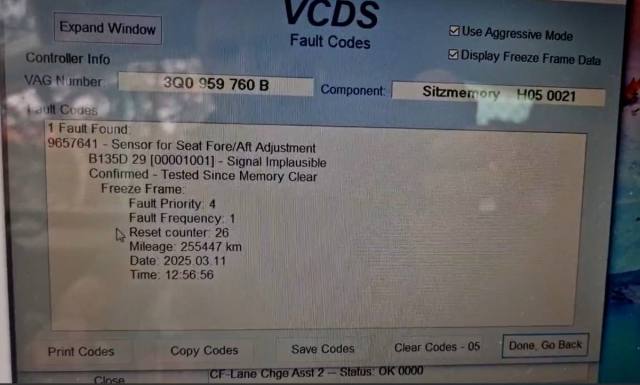

te rog ajuta-ma cu o informatie,
am schimbat scaunele,
am avut scaun sofer semielectric (doar spatar+lombar/masaj), cu incalzire, am pus full electric cu memorie.
La pasager am avut simplu doar inclaizre am pus full electric.
Am cablat CAN ptr scaun sofer,
La pasager am tras fir de alimentare. Toate bune, scaunele functioneaza.
La codare am nevoie de ajutor, am facut unele codari, imi apare si in mib, insa nu functioneaza corect.
Easy entry cateodata merge cateodata nu.
STG 36 > Codificare > Byte 03 > Activează Bit 1
Scaune - Activarea intrării ușoare "Easy Entry" în meniu (scaune electrice)
STG 36 > Codificare > …
•             Byte 09 > Activează Bit 6 (easy_entry_front_over_MMI)
•             Byte 06 > Activează Bit 4 (EasyEntry_Enable_Passenger_over_DriverMMI) (doar dacă STG 06 este instalat)
STG 5F > Ajustare > …
•             Canal "Function_Adaptations_Gen2-menu_display_seat_configuration" > Setează valoarea la "activat"
•             Canal "Function_Adaptations_Gen2-menu_display_seat_configuration_over_threshold_high" > Setează valoarea la "activat"
ENG122227-ENG117556-Car_Function_Adaptations_Gen2-menu_display_seat_configuration,activated ,60
ENG122227-ENG117558-Car_Function_Adaptations_Gen2menu_display_seat_configuration_over_threshold_high,activated ,60
ENG122229-ENG117722-Car_Function_List_BAP_Gen2-driver_seat_0x10,activated ,64
ENG122228-ENG127498-Car_Function_List_CAN_Gen2-Adaptive_key, Mai multe detaliidisponibil 8
ENG122228-ENG117690-Car_Function_List_CAN_Gen2-Adaptive_key_msg_bus, Comfort data bus, 8
ENG122228-ENG127498-Car_Function_List_CAN_Gen2-Adaptive_key,available ,8
ENG122228-ENG117690-Car_Function_List_CAN_Gen2-Adaptive_key_msg_bus,Comfort data bus ,8
am aceasta eroare.........

adpmap-36-3Q0-959-760-B_WVWZZZ3CZHP004885-20250314-142641
;SW:3Q0-959-760-B   HW:3Q0-959-760-B ---  Seat Mem. Drvr
;Component:Sitzmemory    H05 0021, Coding:001000020000050081C481808080000000008181000000F400
;EV_SeatMemorDriveSide,002021,EV_SeatMemorDriveSide.rod
;Friday,14,March,2025,14:26:41:16365
;VCDS Version: Release 23.11.0  Data version: 20231027 DS351.0
;VCID: 3A2D32F51CDC670A217-806E
IDE06869-installation position,Memory seat driver side ,1
ENG123066-vehicle_velocity_monitoring,active ,1
Elapsed Time: 00:00

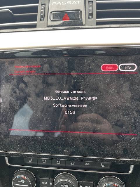

Buna ziua. Detin un Passat model 2020 si de ceva timp unitatea multimedia se restarteaza aleatoriu. Este o problema comuna sau ar putea fi din soft? Nu i-am facut update de firmware pana acum. Am incercat sa descarc de aici https://mib-helper.com/index.php?train=MOI3_EU_VWMQB_P33000P dar returneaza eroare. Multumesc.
Unitatea ta fiind cu soft 156 trebuie trecuta prim mai multe etape de update. Descarci pe rand 270, apoi 324, apoi330. Nu merge direct ca o strici. Fisierul cu 330 de pe mibsolution e corupt. Adu unitatea la 324 macar, cu etapele de mai sus.
Multumesc! O sa incerc. Am descarcat moi3_eu_vwmqb_p27800p si moi3_eu_vwmqb_p32400p de pe pagina https://mibsolution.one/#/1/9/MOI3/Preh/EU/VW
