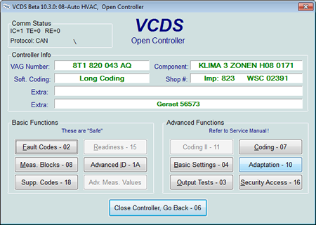

am facut un test cu vcds la masina
si imi zice asa
auto hvac-status mulfunction 0010
2 fault found
01809-actuating motor for temperature flab left (v158)
freeze frame
fault status 01110000
fault priority 3
fault frequency  213
reset counter 248
mileage 147157
time indication 0
date 2050 14 03
01317 control module in instrument cluster (j285)
004-no signal/communication-intermittent
freeze frame;
fault status;00100100
fault priority:5
faul frequncy 2
reset counter 3
mileage 147405
