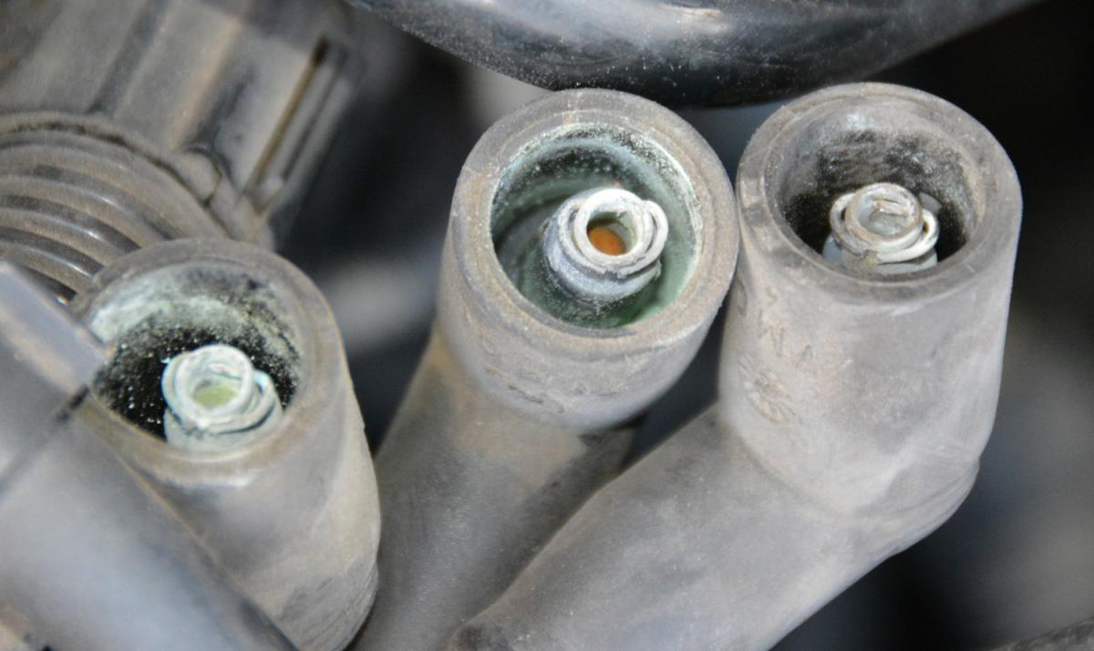

Salut  ! treaba e cam asa      post-107499-0-41031700-1393621216_thumb.

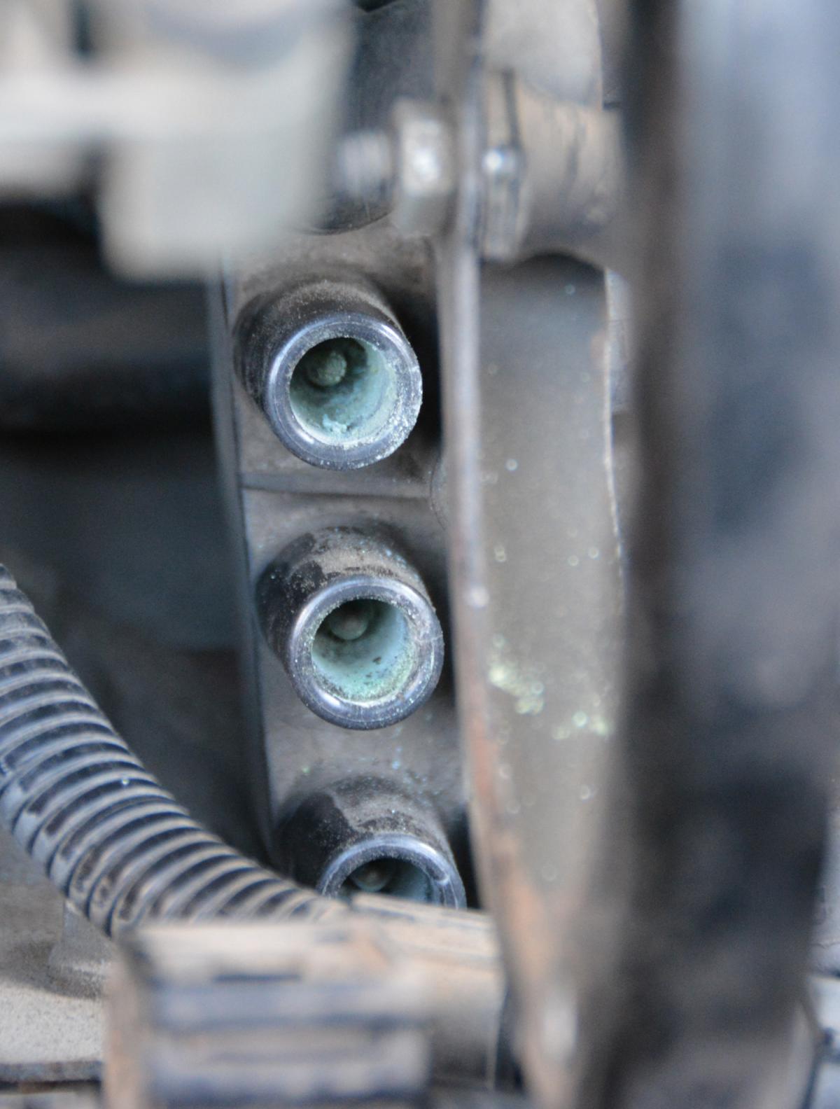

3din 4                                    post-107499-0-98472900-1393621236_thumb.
stie cineva cauza sau rezolvarea ?
