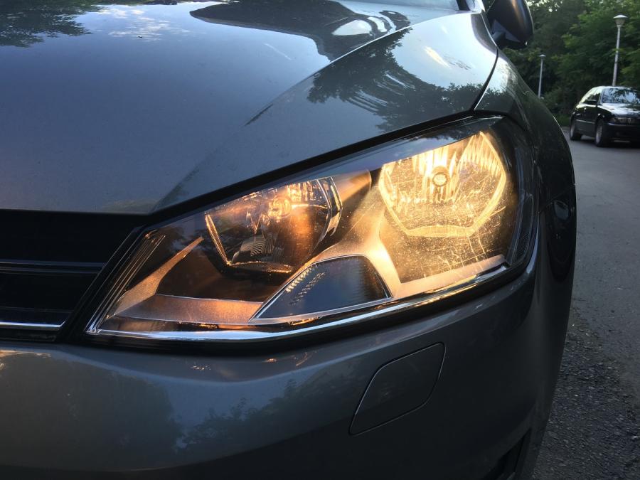

Dreapta stoc (Philips), stanga Osram Night Breaker Laser:
Dreapta stoc (Philips):

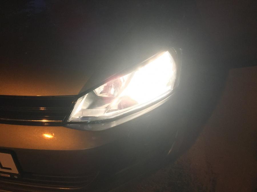

Stanga Osram Night Breaker Laser:

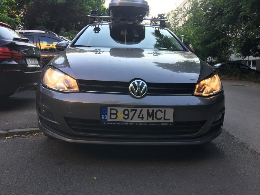

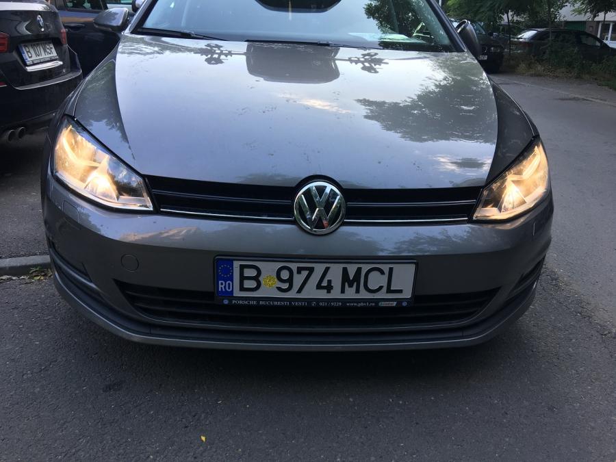

Ambele Osram Night Breaker Laser:

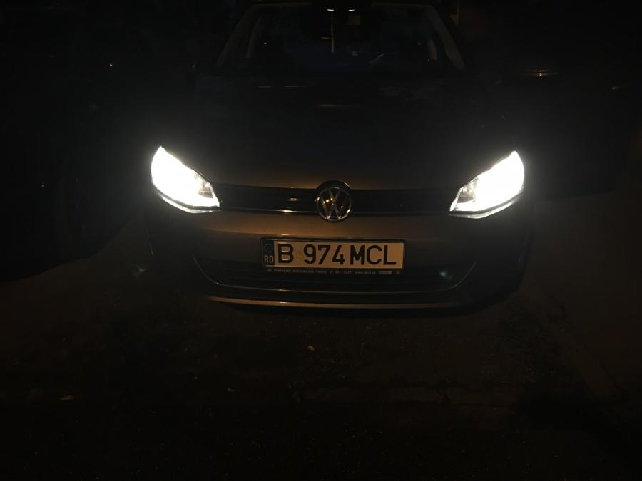

Dreapta Osram Night Breaker Laser:
