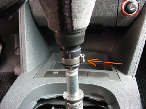

Gata, s-a rezolvat ... acum revin cu o problema ... "nuca" shimbatorului de viteze are un joc lateral ... stie cineva cum pot remedia problema ???
Multumesc anticipat
Numai nuca pe teava sau se misca nuca cu tot cu teava?
"Numai nuca pe teava"
Modificat de Pretender

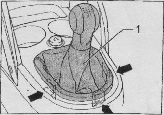

Si la mine se misca dar foarte putin,1-2mm in jurul tevii;daca te deranjeaza desfaci sacul de la schimbator(e prins in 3 clame de plastic pe care le simti pe marginea interioara a lui) tragand de cele 3 clame inspre teava schimbatorului si in acelasi timp tragi si de rama de plastic in sus.Odata ridicat sacul in sus,strangi mai tare inelul de la nuca cu ajutorul unui patent cu cioc subtire.Uite cum arata inelul de la nuca VW(sistemul de prindere e identic cu cel de la Seat)post-5905-1190997059_thumb.jpg
@alteacupra ... esti tare ... am reusit sa-l strang fara probleme ... numai bine

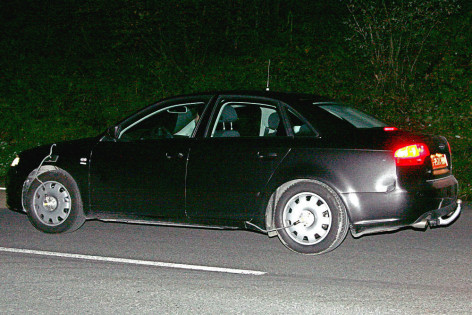

post-5905-1194090541_thumb.jpgAsa va arata noul Toledo din 2009(ca si noul Audi A4,parerea mea...)
Parerea ta, ai zis bine. Ce ai pus tu in poza aia e un mule, adica caroserie de A4 modelul vechi, pentru a testa viitorul sasiu si platforma tehnica pentru Toledo. Acesta va fi intradevar bazat pe vechiul A4, dar in nici un caz nu va arata asa.
Amanunte in linkul urmator:
http://www.worldcarfans.com/9071002.006/fi...loon-spy-photos
"Seat has been testing an early mule for their upcoming range-topping sedan under the cover of darkness and a small army of security guards. Our spy photographers still managed to catch this test mule in the Swiss Alps undergoing road-testing only days after catching Seat's brand new Ibiza.
The new Seat model is based on the old, outgoing Audi A4 and even though Audi has no more use for the platform, it is still a very modern, safe and agile foundation to work from. The test mule, with Seat's new front design securely taped up, still mostly resembles the A4, but the wider and lower radiator will be accompanied by more Seat particular styling cues when the project progresses.
From Seat's statement in May 2007: “SEAT will have two versions: a saloon and an estate car....whose market launch is planned for 2009”. Stay tuned for more on the topic when it becomes available."
