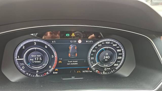

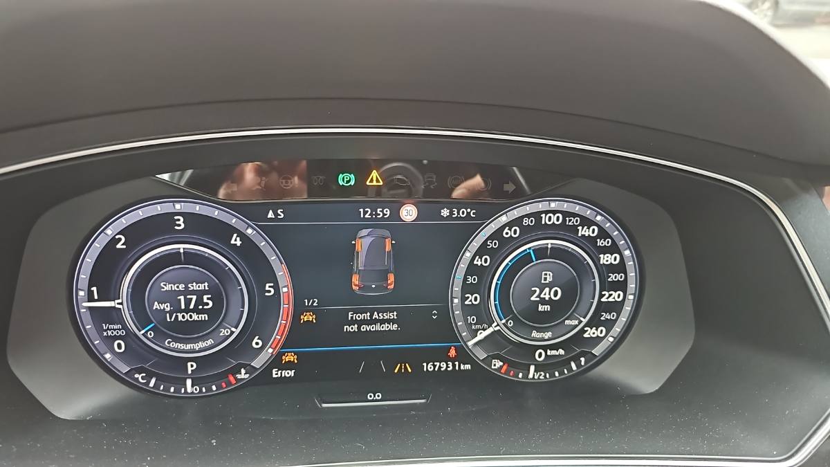

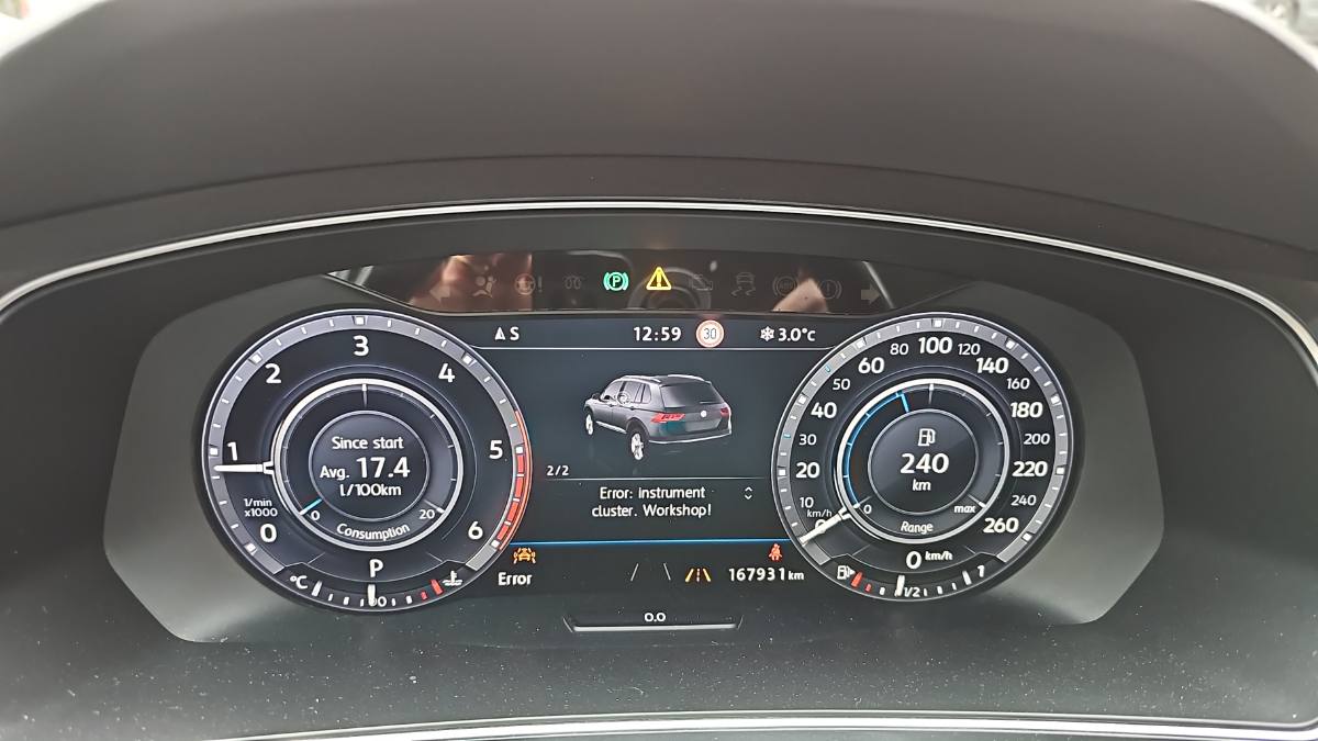

    Probleme Cu Avertizarea Sonora - Buzzer ars
    In Bucuresti sau prin apropiere cineva care ma poate ajuta? E vorba de un tiguan din 2017 .De cand cu frigul am aceasta erroare si nu se aud sunetul de semnalizare si centura care dispare dupa ce merg cu masina 20-30 min ( se incalzeste interiorul masini)si sunetul devine la normal. La inceput am crezut ca era de la baterie am schimbat si bateria zilele trecute dar vad ca lafel se comporta. Din cea ce am citit ar fi buzzeru de vina. Errori: Address 17: Instruments Labels: 5G0-920-XXX-17.clb-SRI3 Control Module Part Number: 5NA 920 791 A HW: 5NA 920 791 A Component and/or Version: KOMBI 408 2170 Software Coding: 07A400086F84000801887B033401000000000000 Work Shop Code: WSC 01357 011 00200 ASAM Dataset: EV_DashBoardVDDMQBAB 009052 (VW37) ROD: EV_DashBoardVDDMQBAB_009_VW26.rod VCID: 4189F003D089C3810D-8014 1 Fault Found: 10485828 - Internal Control Module Memory Check Sum Error B2000 41 [009] - General Checksum Failure [New feature! Extended UDS fault detail is only supported by current gen. interfaces] Confirmed - Tested Since Memory Clear Freeze Frame: Fault Status: 00000001 Fault Priority: 2 Fault Frequency: 1 Mileage: 167425 km Date: 2026.01.30 Time: 10:26:12 Address 5F: Information Electr. Labels: 5G0-035-MIB-STD2.clb Control Module Part Number: 3Q0 035 864 B HW: 3Q0 035 864 B Component and/or Version: MU-S-N-ER 840 0764 Software Coding: 02730601FF0000005111000100080A231F0100E4012000008F Work Shop Code: WSC 01357 011 00200 ASAM Dataset: EV_MUStd4CDELP 001001 (VW37) ROD: EV_MUStd4CDELP_VW26.rod VCID: 306FA5C76B235A09F2-8064 1 Fault Found: 1555 - Check Software Version Management B201A 00 [009] - - [New feature! Extended UDS fault detail is only supported by current gen. interfaces] Confirmed - Tested Since Memory Clear Freeze Frame: Fault Status: 00000001 Fault Priority: 6 Fault Frequency: 1 Reset counter: 31 Mileage: 167920 km Date: 2026.02.09 Time: 22:16:22 Voltage terminal 30: 14.4 V Status_Software_Version_Management-module_name: C
  3. devis25
    Buzzer - probleme
    De cand cu frigul am aceasta erroare si nu se aud senalizarile si centura (sunet)care dispare dupa ce merg cu masina 20-30 min. La inceput am crezut ca era de la baterie am schimbat si bateria zilele trecute dar vad ca lafel se comporta. Suspectez sa fie de la buzzer. E vorba de un Tiguan din 2017 cu ceasuri digitale. Daca ma poate ajuta cineva ca nu ma pricep sau sa ma indrume la cineva care se ocupa de asa ceva . Pun erroare si errorile la scanare. Multumesc New Text Document (2).txt New Text Document.txt
