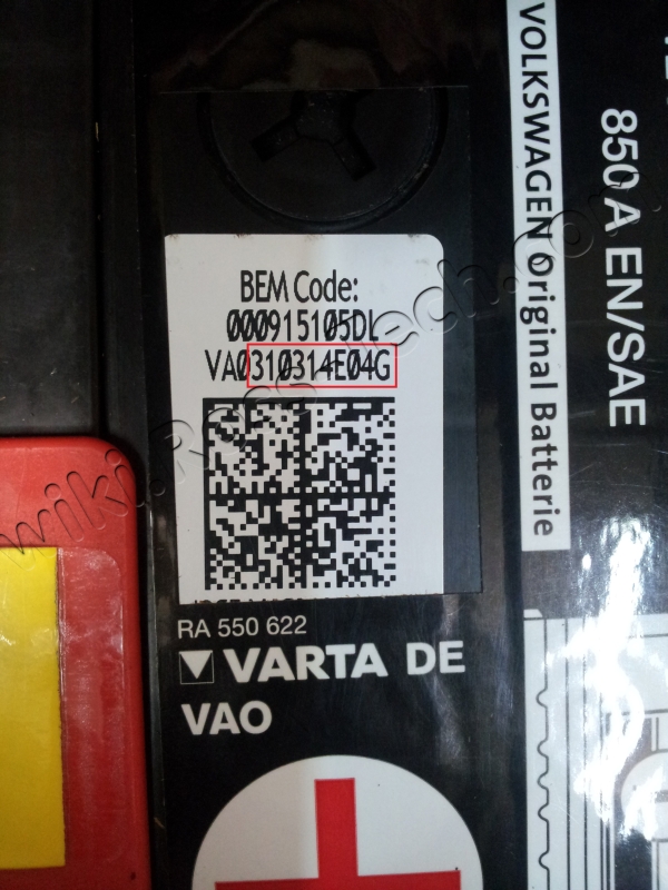

Your new Battery should now be coded and the Battery Control Module should be aware of the new Battery.
Note: The 10 digit serial number may be preceded by the battery vendor code, for instance VA0 of Varta. If the code is VA0310314E04G then drop the VA0 and just enter 310314E04G. Sometimes the battery part number sticker can cover up the white sticker with the serial number.
post-21426-0-05652900-1330018096_thumb.j
