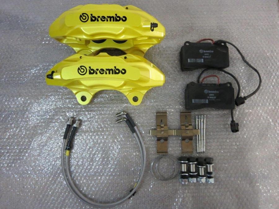

salut , cel mai bun upgrade pret performata  ptr mk6
etrieri touareg 4 pistoane
discuri mercedes c 230  330mm
