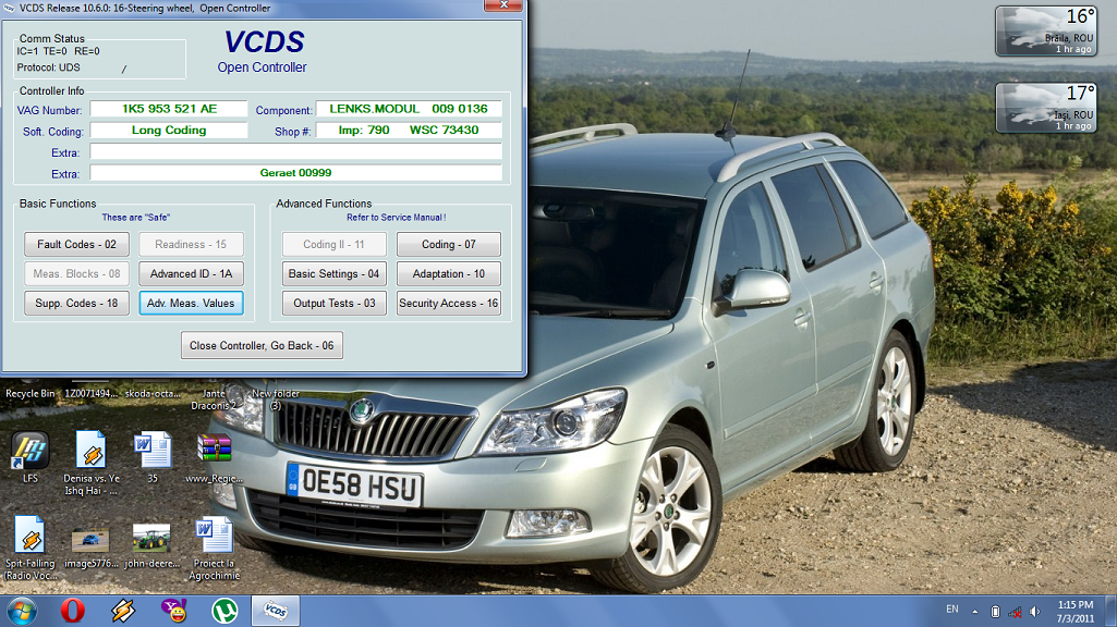

Address 16: Steering wheel (J527) Labels: 5K0-953-569.clb
Part No SW: 1K5 953 521 AE HW: 5K0 953 569
Component: LENKS.MODUL 014 0140
Revision: FF010040 Serial number: 20110421301969
Coding: 4080040000
Shop #: WSC 73430 790 00126
ASAM Dataset: EV_SMLSNGVOLWSXS A01004
ROD: EV_SMLSNGVOLWSXS_SK35.rod
VCID: 70E5A164ABB80CE
