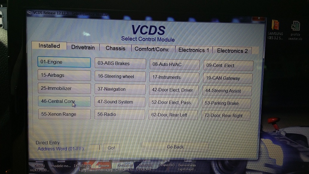

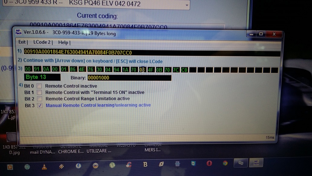

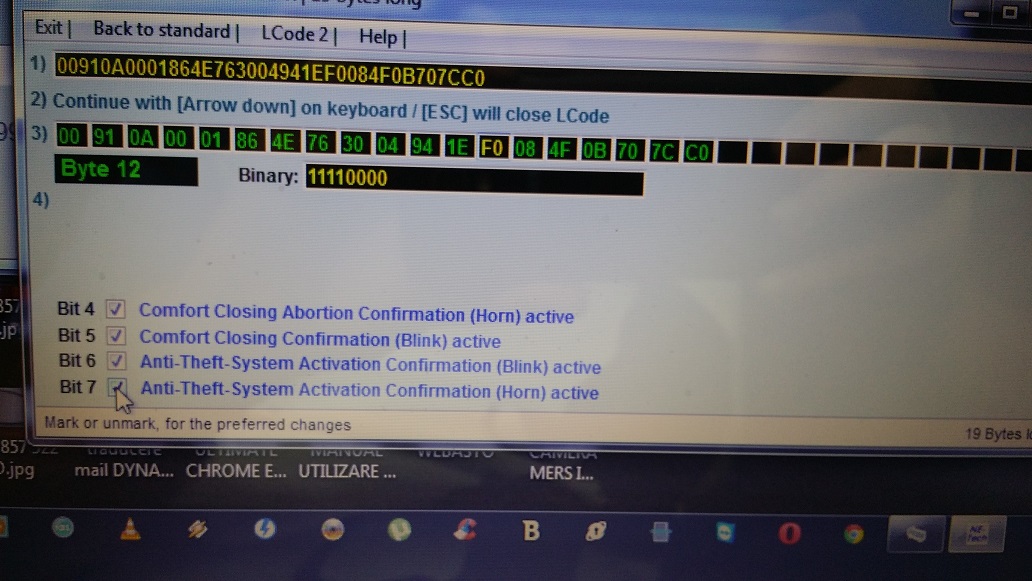

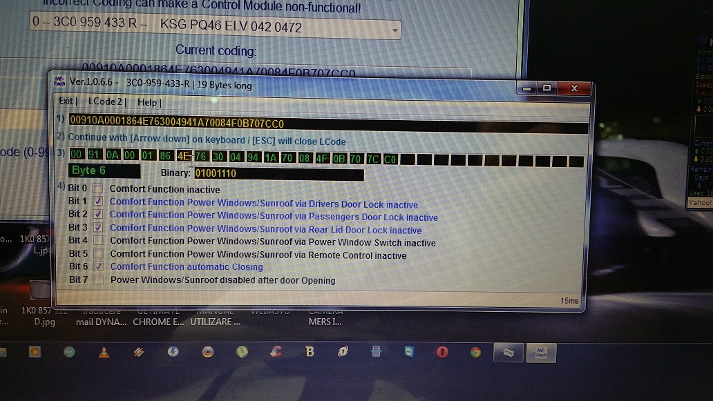

Ieri am reusit sa termin de montat si eu sirena dar am o mica / mare problema .
Suna foarte incet (mai precis piuie) exact cum se aude in fisierul atasat (care nu se poare atasa in nici un format ZIP / RAR / ETC) .
DIN PACATE MA OPRESC AICI DEOARECE NU POT ATASA FISIERUL AUDIO DE 14 SECUNDE CU SUNETUL SIRENEI .

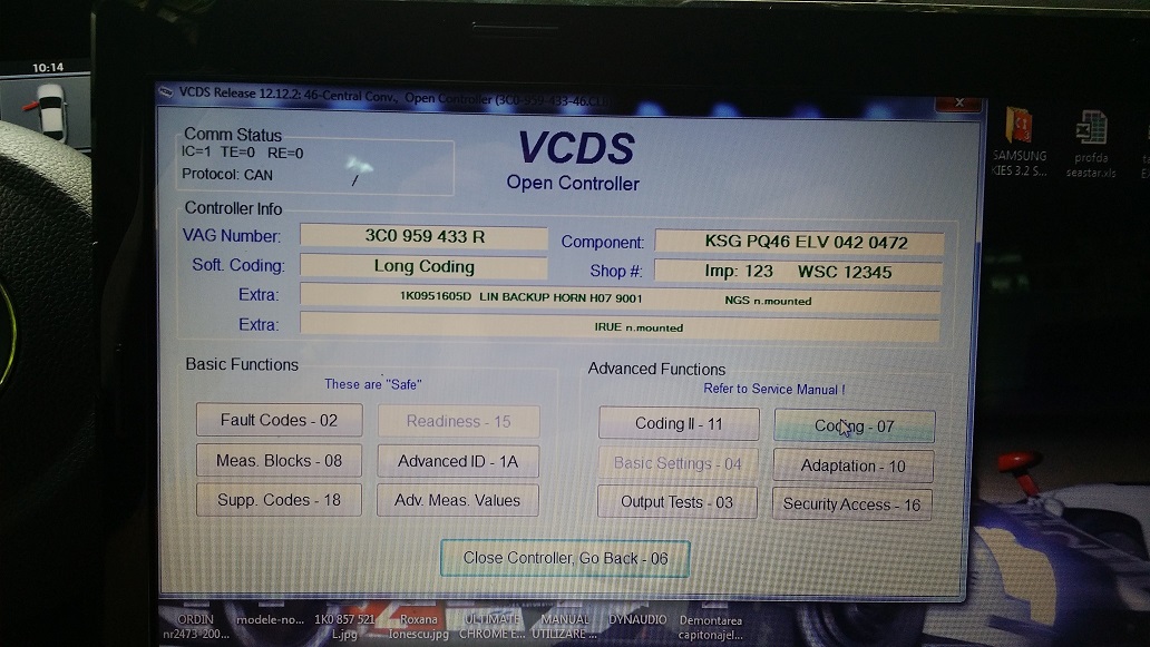

O sa atasaz totusi ceea ce apare pe VCDS dar care fara fisierul cu SUNETUL SIRENEI NU ARE NICI O VALOARE deoarece cu ajutorul lui se putea observa cat de incet suna .

post-20331-0-99753000-1408788183_thumb.j post-20331-0-00239600-1408788199_thumb.j post-20331-0-48035300-1408788217_thumb.j post-20331-0-86300700-1408788227_thumb.j post-20331-0-14649200-1408788240_thumb.j post-20331-0-09790900-1408788249_thumb.j post-20331-0-00951600-1408788267_thumb.jpost-20331-0-22159500-1408788349_thumb.j post-20331-0-52236900-1408788360_thumb.j post-20331-0-40373600-1408788368_thumb.j post-20331-0-95926400-1408788374_thumb.j post-20331-0-23422700-1408788382_thumb.j post-20331-0-31777500-1408788394_thumb.j post-20331-0-71248300-1408788504_thumb.j

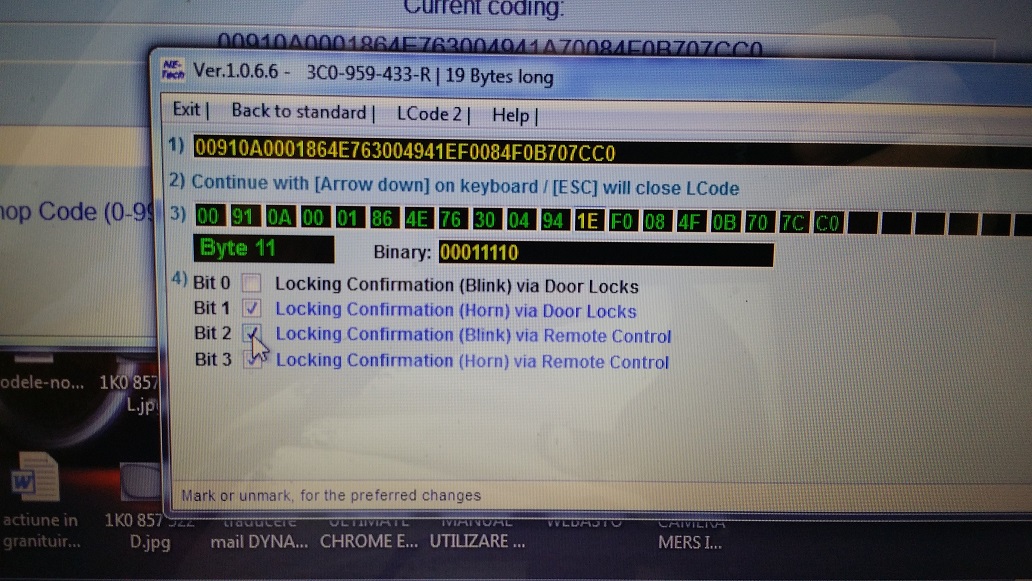

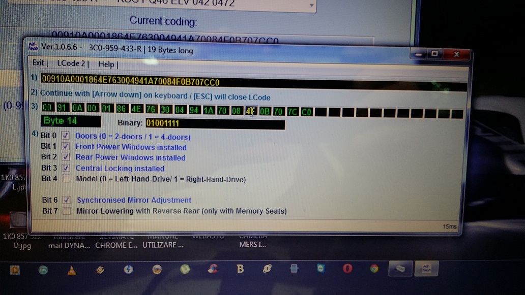

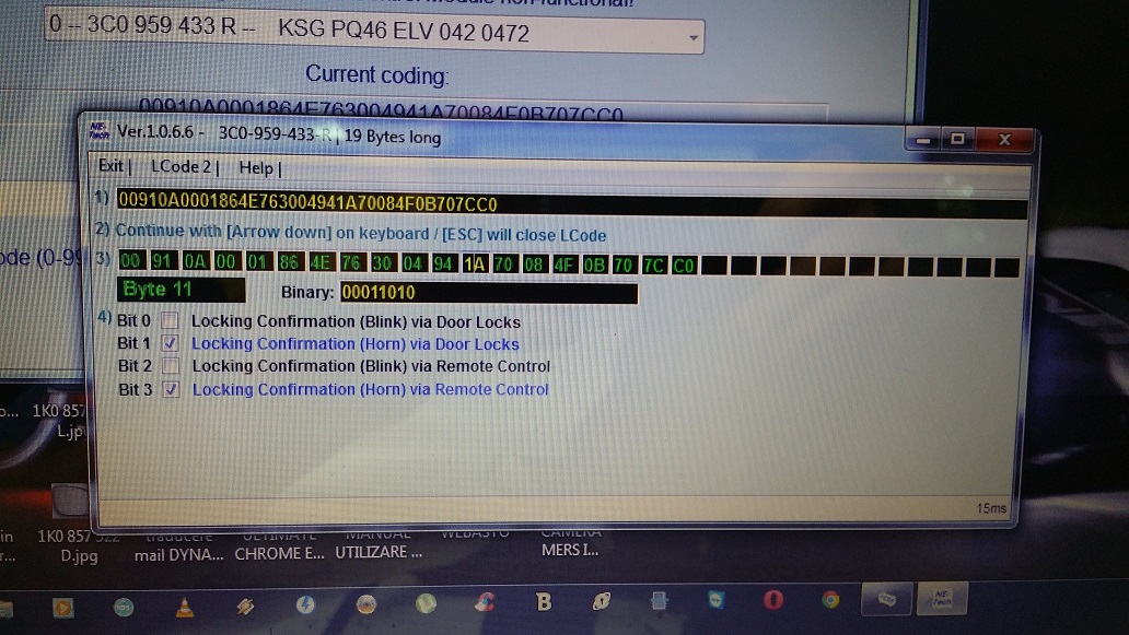

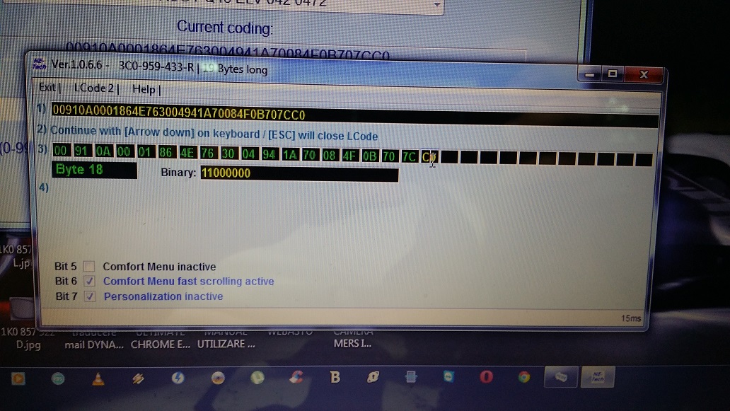

Si acum ce am mai bifat azi dimineata :
post-20331-0-38306200-1408788585_thumb.j post-20331-0-74778100-1408788610_thumb.j post-20331-0-69274500-1408788973_thumb.j

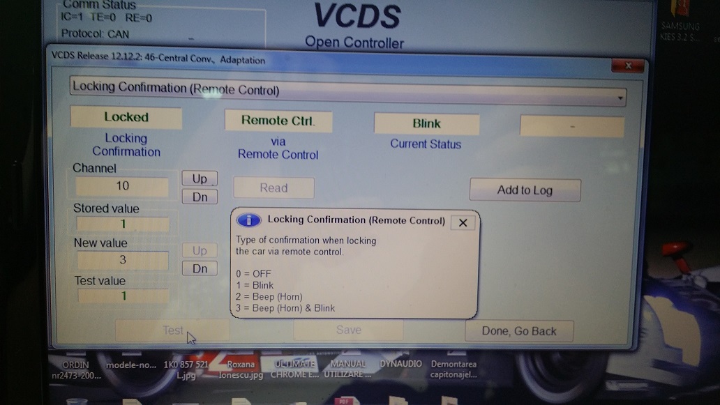

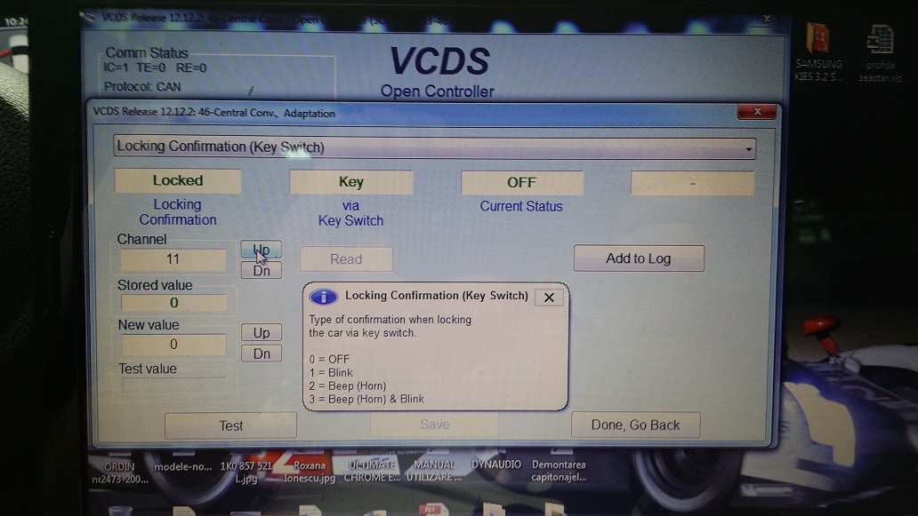

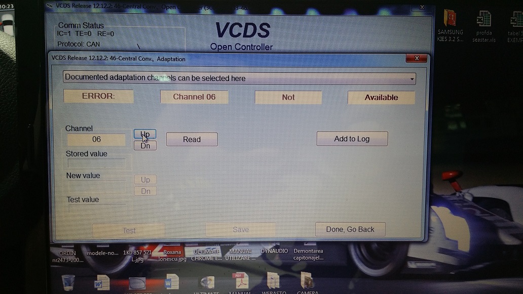

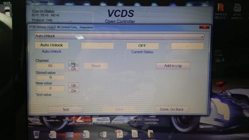

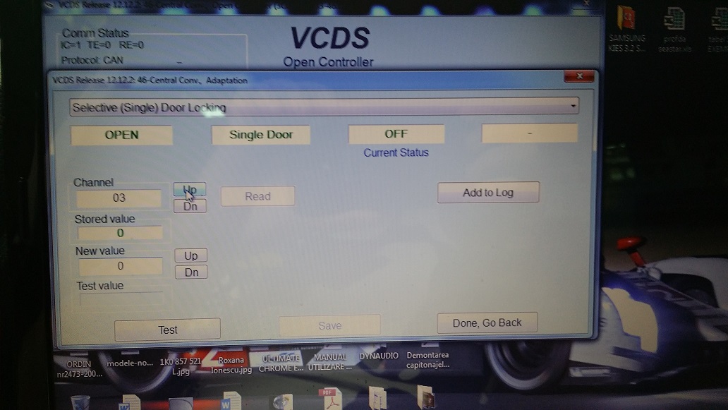

Iar astea sunt casutele din Adaptation :
post-20331-0-64805600-1408789010_thumb.j post-20331-0-21042300-1408789056_thumb.j post-20331-0-98614900-1408789062_thumb.j post-20331-0-12032900-1408789072_thumb.j post-20331-0-63189100-1408789083_thumb.j post-20331-0-91197300-1408789093_thumb.j post-20331-0-26064700-1408789103_thumb.j
post-20331-0-31228000-1408789211_thumb.j post-20331-0-55330400-1408789219_thumb.j post-20331-0-86702200-1408789235_thumb.j post-20331-0-94319000-1408789243_thumb.j post-20331-0-39169500-1408789271_thumb.j post-20331-0-54811400-1408789281_thumb.j post-20331-0-25103800-1408789289_thumb.j

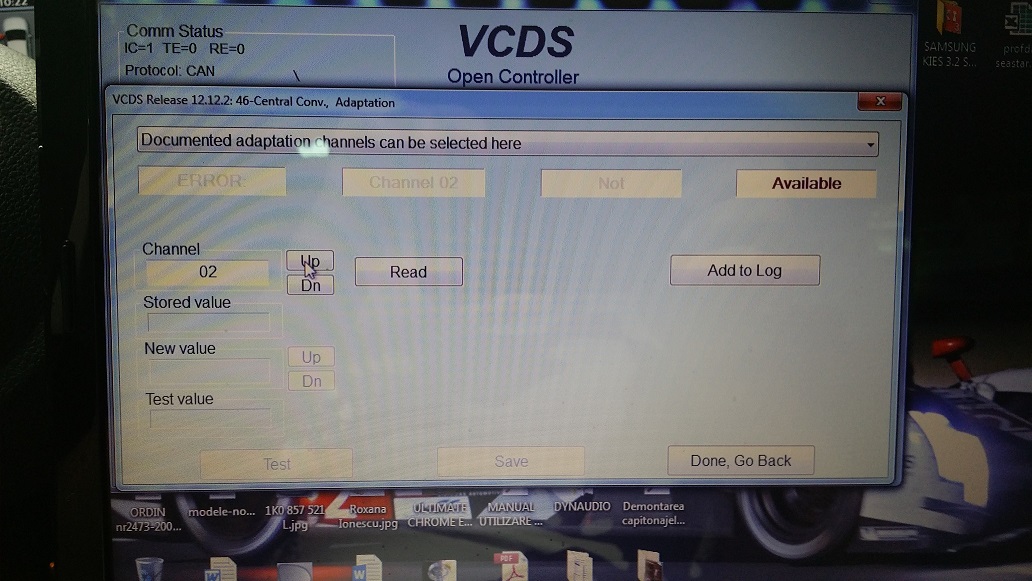

Iar aici e lista cu ce reprezinta fiecare canal din adaptari :
post-20331-0-38755600-1408789550_thumb.j

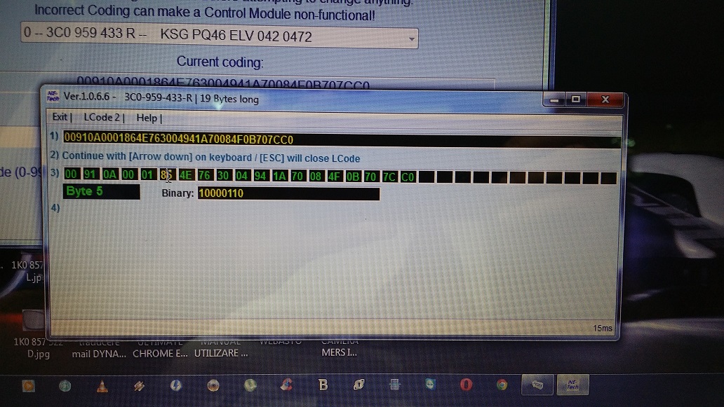

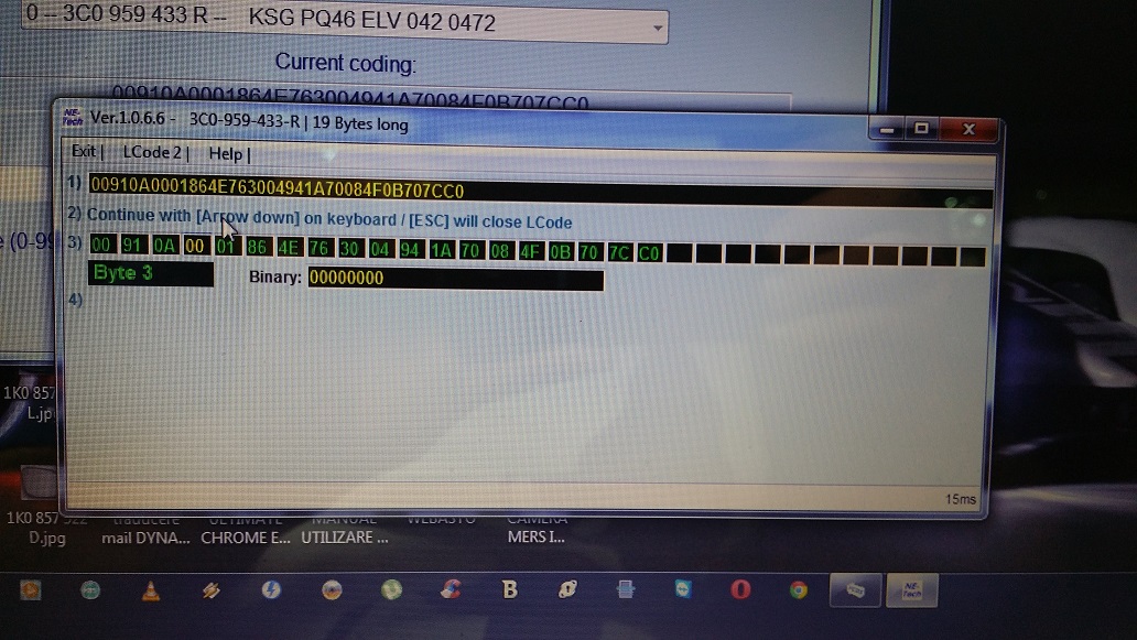

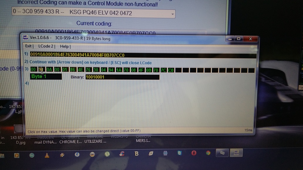

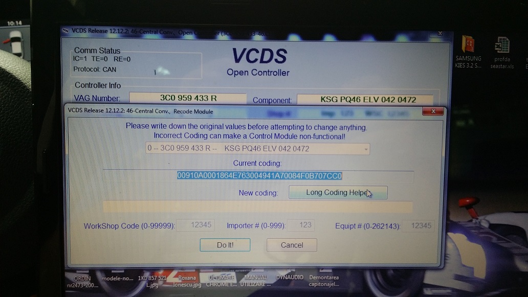

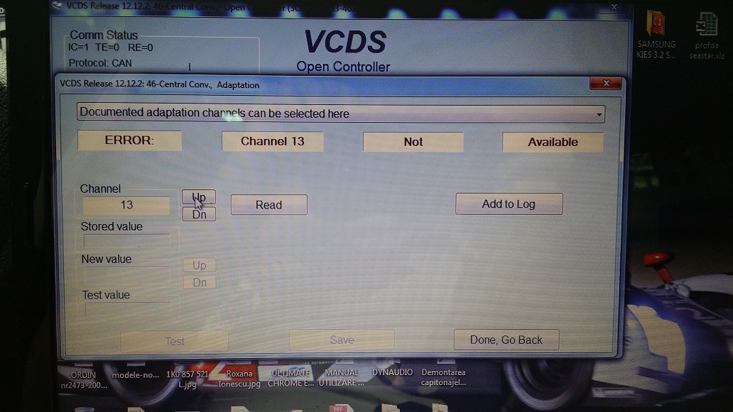

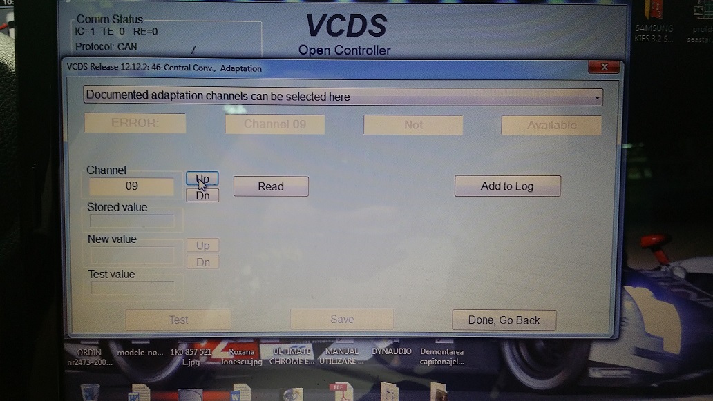

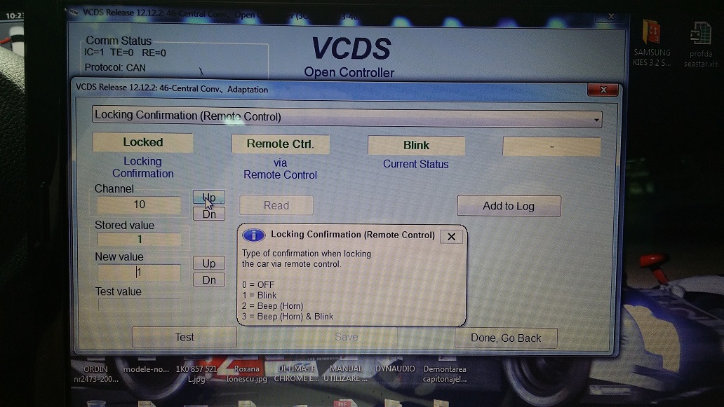

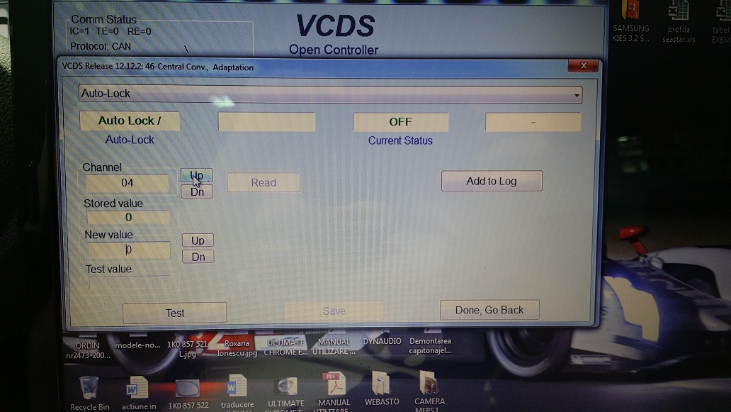

Iar dupa cum mi-a zis Florin aseara sa fac modificarea in Adaptari la canal-ul 13 la mine acesta da eroare .
Am incercat sa modific lcanal-ul 10 si la fel nu ma lasa sa dau SAVE :
post-20331-0-65247700-1408789720_thumb.j

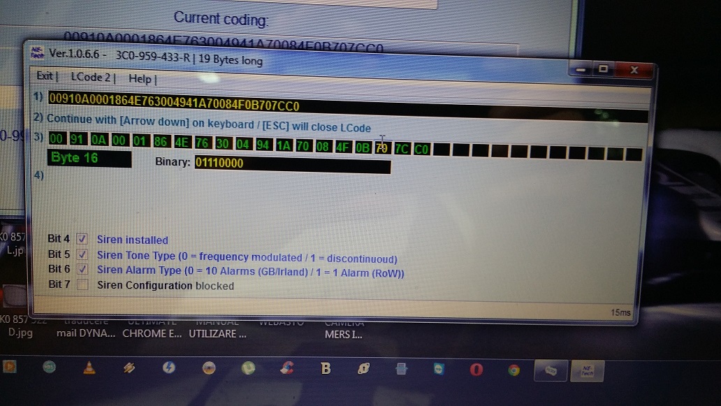

Ce codare sa fac exact si unde (LA CE BITI) pentru a avea acces mai complet la adaptari ?

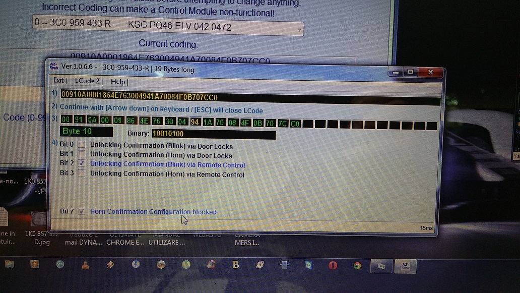

Intra la Alarm horn adjustment. Pentru a atasa fisierul arhieaza-l cu zip-ul si il atasesi aici. Debifeaza Horn configuration blocked - byte 10 bit 7 pentru a incerca setarea sunetului. spor
Ia uitati cum suna :
SIRENA.zip
O sa incerc si cum ai spus tu pronet .
Modificat de @DRI@N
Tot nu pot accesa Alarm horn adjustment .
Byte 10 bit 7 trebuie debifat.
Byte 15 bit 0 la fel.
Am rezolvat .
Acum pot intra pe Alarm horn adjustment dar la inchidere sunetul si volumul nu poate fi schimbat ci doar felul in care suna alarma in cazul unei efractii .
De altfel mi-a confirmat acest lucru si colegul "gaborvad" cu un filmulet trimis pe mail in care sirena lui face la fel ca a mea la inchiderea masinii .

Dap! Doar sunetul la efractie se poate modifica.
La incuiat/descuiat se poate activa sau dezactiva, imperecheat cu avariile sau nu.
Lucruri pe care le stiam (cu totii) dinaintea montarii sirenei.
