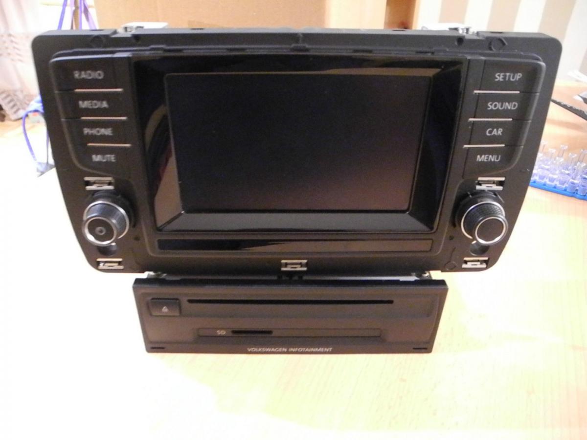

Oare la B6,B7,CC sau G5/G6 ar merge composition media?
