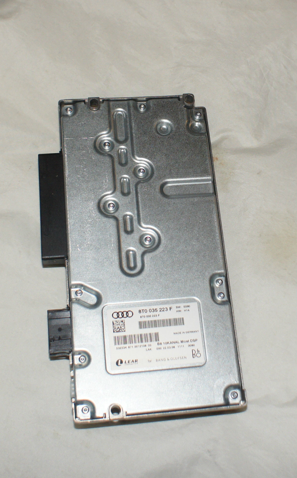

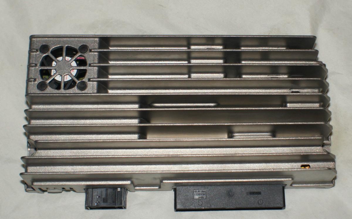

L-am demontat si este 8t0035223f , cel cu T a venit ulterior ca si inlocuitor,dar ma interesa cele cu M sau C daca se potrivesc.

aceste info am gasit pe net dar nu stiu cata incredere sa am:
Brand:
AUDI/BANG & OLUFSEN
Placement on Vehicle:
Right, Rear
Manufacturer Part Number:
8T0035223T
Interchange Part Number:
8T0-035-223-F; 8T0-035-223-M
Other Part Number:
8T0035223C; 8T0035223F; 8T0035223M

@multivan_t4   F-ul este compatibil doar cu T,T-ul este urmasul lui ca cod de piesa dupa schimbarea din 2008.
GABIVVX,multumesc.
Pe un alt forum mi-a zis cineva ca F l-a inlocuit pe M iar T pe F.Acum ca si piesa noua vine T.

Mie doar atat imi scoate.Ele teoretic pot merge dar practic in functie de sistemul audio al masinii,daca este echipata cu navi sau telefon din fabrica,daca montezi o statie nepotrivita e posibil sa nu aiba toate functile complete sau e posibil sa nu fie compatibila la claritatea sunetului cu boxele de pe masina.
Sunt in jur de 10 modele de ,,statie'' in perioada aia de fabricatie si tocmai asta face diferenta intre ele....asa faceau astia 1 model de ,,statie'' care era bun la toate echiparile si terminau povestea.
  8T0035223A  amplifier for sound system. amplifier for sound system; for vehicle with active; loudspeakers; PR-9VD
  8T0035223AD  amplifier for sound system. amplifier for sound system; for vehicle with active; loudspeakers; PR-9VD
 8T0035223K  amplifier for sound system. amplifier for sound system; for vehicle with active; loudspeakers; PR-9VD
 8T0035223P  amplifier for sound system. amplifier for sound system; for vehicle with active; loudspeakers; PR-9VD
  8T0035223C  amplifier for sound system. amplifier for sound system; for vehicles with premium; loudspeaker system; PR-9VK
 8T0035223M  amplifier for sound system. amplifier for sound system; for vehicles with premium; loudspeaker system; PR-9VK
 8T0035223E  amplifier for sound system. amplifier for sound system; for vehicles with 4; loudspeakers; PR-8RX
 8T0035223N  amplifier for sound system. amplifier for sound system; for vehicles with 4; loudspeakers; PR-8RX
 8T0035223AE  amplifier for sound system. amplifier for sound system; for vehicles with 4; loudspeakers; PR-8RX
 8T0035223Q  amplifier for sound system. amplifier for sound system; for vehicles with 4; loudspeakers; PR-8RX
8T0035223G  amplifier for sound system. amplifier for sound system; for vehicle with active; loudspeakers; PR-9VD
8T0035223R  amplifier for sound system. amplifier for sound system; for vehicles with 4; loudspeakers; PR-8RX
  8T0035223AG  amplifier for sound system. amplifier for sound system; for vehicle with active; loudspeakers; PR-9VD  1
8T0035223T  amplifier for sound system. amplifier for sound system; for vehicles with premium; loudspeaker system; PR-9VK
