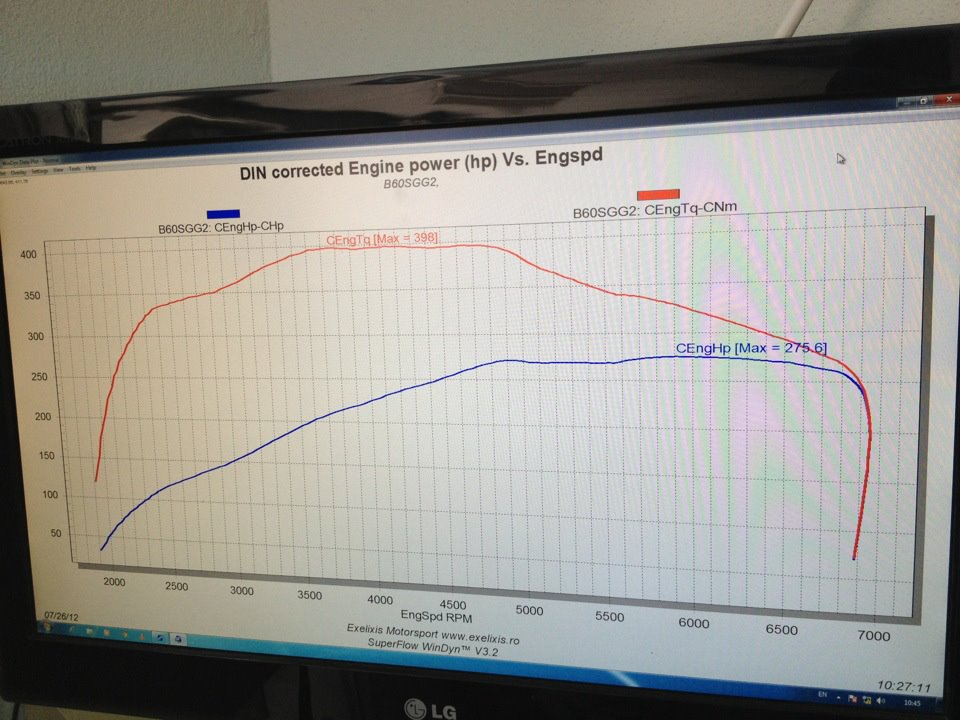

stage 2 pe noul dyno exelixis
post-15101-0-69052700-1344186013_thumb.j post-15101-0-95094000-1344185940_thumb.j
dupa pompa APR + valva de RS4 urmeaza stage 2+
post-15101-0-02666600-1344186090_thumb.j
o comparatie intre stage 2 si stage 2+
post-15101-0-82894200-1344186112_thumb.j
