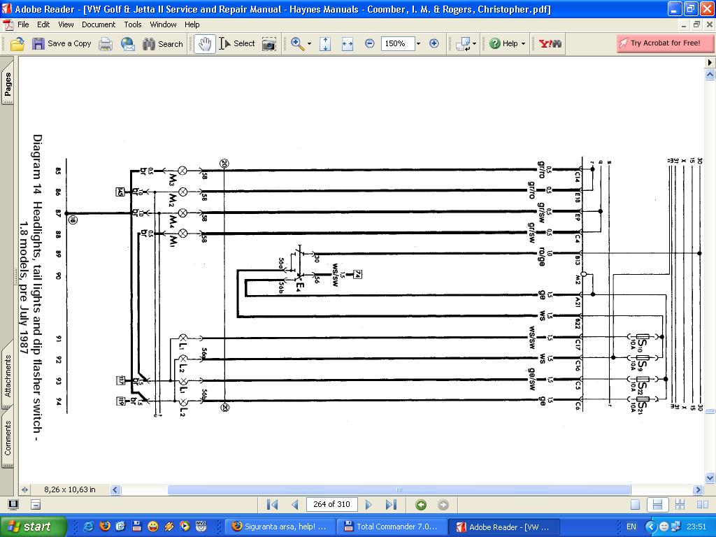

vezi in schema electrica ce traseu corespunde sigurantei 21. Pt exemplificare ia ca model schema urmatoare:
S21 este siguranta 21.
L1 - twin filament headlight bulb, left
L2 - twin filament headlight bulb, right
M1 - parking light bulb, left
M2 - tail light bulb, right
M3 - parking light bulb, right
M4 - tail light bulb, left
