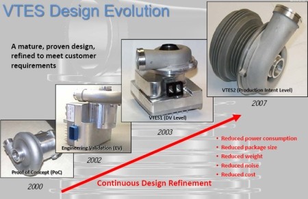

"Controlled Power Technologies is prepared to bring an electric supercharger to market in the next, according to a press release issued this week. The electric superchargers are supposed to be affordable and will work on all gas and diesel engines, including engines already equipped with a turbocharger.
Adding an electric supercharger will allegedly take 40 percent off the time required to sprint from 45 to 65 mph in top gear. The supercharger is able to deliver a nearly instant burst of air to the engine. Such a supercharger is said to be plug and play as it is not driven by a belt, like a traditional supercharger. Several automakers are reportedly interested in using the electric supercharger, but none have been named yet."

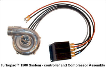

Se pare ca superchargerul electric de la turbodyne vine impreuna cu o unitate de control care se conecteaza la unitatea masinii. Aceasta unitate comanda turbina in functie de necesitatile motorului (pornire, depasiri, pante, etc) de asemenea si amestecul aer/combustibil este comandat tot de aceasta unitate (a se vedea in poze)
Referitor la punctul 2 motoarele de mic litraj vor veni direct echipate cu asemenea compresoare - deci problema suprasolicitarii motoarelor este eliminata chiar de proiectanti, problema se pune la cele vandute aftermarket dar care - imi dau si eu cu parerea - probabil prin aceasta unitate de comanda vor avea o limitare a presiunii aerului injectat pana la specificatiile pe care le suporta motorul respectiv, dar cine vrea senzatii tari si eventual scoate limitarea o face pe propriul risc.

In sprijinul afirmatiei vine si recomandarea de pe site-ul lor: "TurbopacTM is an electrically operated air enhancement device and its incorporation into an engine may require modifications to the fuel, ignition and electronic control systems of an engine. Modifications should be done by expert installers".
