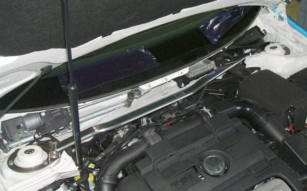

ARC POWER BRACE Type-1 Golf5/Golf6/Jetta/Golf Variant/Skoda/Scirocco (un produs bine facut,nu necesita modificari) :icon_thumright:
