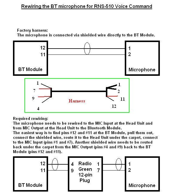

Volkswagen RNS 510 Firmware Upgrade to version 4020 / 4024 / 4026 / 4028
Version 4020/4024/4026/4028 firmware for the Volkswagen RNS 510 and the Skoda Columbus has been released.
  • Voice Control (requires microphone – see Volkswagen RNS 510 Microphone Connection for voice control)
