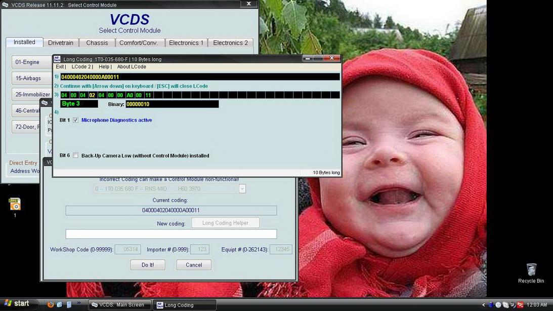

am montat azi un RNS 510 versiunea F, totul merge perfect mai putin ca am o eraoare in vcds:
Address 37: Navigation (J0506)       Labels: 1T0-035-680.clb
   Part No SW: 1T0 035 680 F    HW: 1T0 035 680 F
   Component: RNS-MID       H60 3970
   Revision: AB001001    Serial number: VWZ6Z7N9623151
   Coding: 04000402040000A00011
   Shop #: WSC 05314 123 12345
   ASAM Dataset: ------------------------- ------
   VCID: 3162A2AE68327BB
1 Fault Found
01523 - Microphone for Telephone (R38)
            011 - Open Circuit
             Freeze Frame:
                    Fault Status: 01101011
                    Fault Priority: 5
                    Fault Frequency: 1
                    Reset counter: 63
                    Mileage: 29886 km
                    Time Indication: 0
                    Date: 2018.14.13
                    Time: 22:00:38
a fost codat inainte cu ceva ce nu am eu acum pe masina(microfon) sau nu stiu de la ce o fi
 si asta imi apare pe can desi nu o aveam inainte, tot de cand am instalat rns ul
Address 19: CAN Gateway (J533)       Labels: 7N0-907-530-V2.clb
   Part No SW: 7N0 907 530 H    HW: 1K0 907 951
   Component: J533  Gateway H42 1620
   Revision:   H42       Serial number: 04081101270229
   Coding: 351002
   Shop #: WSC 00066 000 00000
   VCID: 356A96BE9C5A57B
1 Fault Found
01044 - Control Module Incorrectly Coded
            000 -  -
             Freeze Frame:
                    Fault Status: 01100000
                    Fault Priority: 1
                    Fault Frequency: 1
                    Mileage: 29886 km
                    Time Indication: 0
                    Date: 2018.14.13
                    Time: 21:59:15
daca incerc sa o sterg reapare pe loc inapoi
ai bifat in CAN GATEWAY si NAVIGATION?
chiar daca ai dat acolo la navigation...long code helper...., in can trebuie sa bifezi navigation la instalation list.  Vezi daca e bifat!
Modificat de caseac
micuzzu_marius
nu stiu daca e bifat in can si navigation, doar am montat rns ul, e exact codat cum era cu rcd ul inainte, o sa bifez in lista si navigation, desi mi l arata langa celelalte module engine, abs, airbaggs etc(o data ce mi l arata ma gandesc ca e bifat deja)
Vezi ca probabil RNS-ul nu este nou, si a fost codat pe alta masina, probabil, are memoria lui.
Deci intra pe navigation, si cauta unde este bifat microfon, tu probabil nu ai microfon pe masina deloc, sau daca ai, nu e cablat ca si comanda vocala pentru rns - este diferit de cablajul de la bluetooth.
Debifezi acolo unde scrie microfon, si ar trebuie sa-ti dispara ambele errori.
Daca nu te descurici, zi-mi, o sa merg cu vag-com-ul in masina, si iti zic exact.
sigur nu ai codat 19-Can gateway - intra la Installation list si bifeaza.
micuzzu_marius
asta era, nu am bifat si adresa 37 navigation, am vazut ca navigatia merge ma gandeam ca e suficient ca e bifat radio, cum am bifat si navigatia pe can nu a mai aparut eraoea cu cu codare incorecta si m a lasat sa dezactivez si microfonul ca sa nu mai am eroare

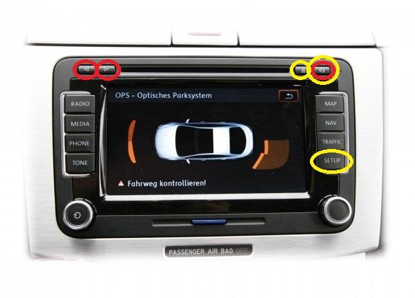

 Profit de aceasta postare ca sa revin cu rugamintile facute anterior  (cumse face resetul la varianta F (ce butoane ) ;daca se pot pune alaturi de hartile Est si hartile West in hard fara a le sterge pe primele, ce varianta de harti West exista acum  siii...daca e cineva dispus sa ma ajute cu procurarea de harti West , desigur  contra cost )
Multumesc pentru sugestii !!
 Scuze... asa-i cand te apuci sa scrii cu capul in taste fara sa citesti Am inteles ca nu merg hartile est si west impreuna ci pe rand...
Multumesc celorlalti pentru idei si ajutor.
Scuze .. again :)
Tu acuma ar fi culmea sa renunti, dupa ce te-ai chinuit sa tragi firul si restul.
Sper sa-ti iasa asa cum vrei tu retrofitul.
Legat de resetare RNS, sunt 2 metode: vezi in poza cu ROSU sau cu GALBEN.
Cu GALBEN dai reset cand vrei sa faci upgrade, si reset simplu cu ROSU.
Downgrade se face din setari, la system ai optiune ENABLE DOWNGRADE.
Cat despre harti, ai o sigura otiune, o versiune o copiezi pe hard si cealanta o poti rula direct de pe DVD fara sa mai copiezi pe hard.
