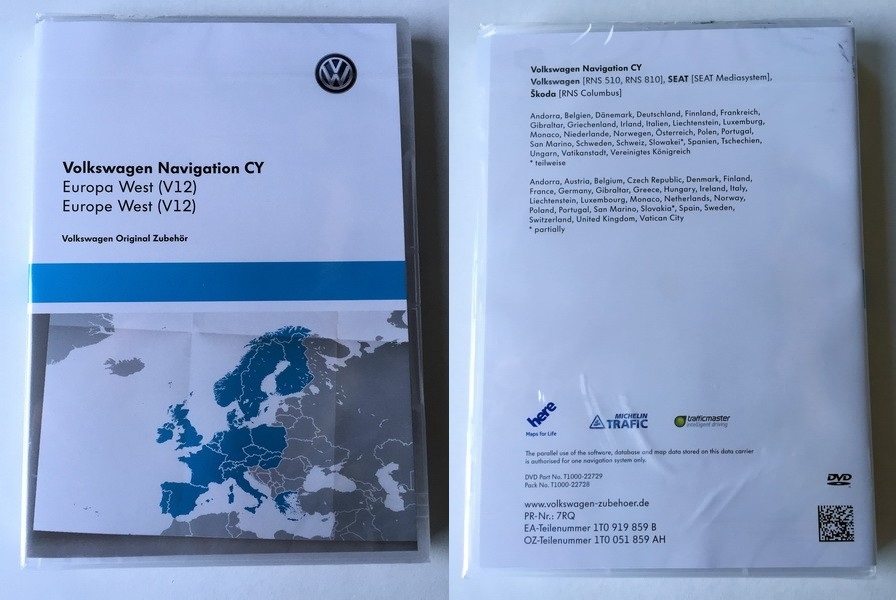

news...
Volume: CD_8196
Date: 7.7.2014
db: EEU(2014Q1)
Area: East Europe
Subarea: East
Supplier: Navteq
Version: 505.30.412.84
Customer Version: V12
1T0 051 859 AJ
Volume: CD_8195
Date: 7.7.2014
db: EU(2014Q1)
Area: West Europe
Subarea: West
Supplier: Navteq
Version: 505.20.412.84
1T0 051 859 AH
post-47515-0-42692200-1416291697_thumb.j
post-47515-0-00390600-1416291705_thumb.j
Modificat de Nutu2009
