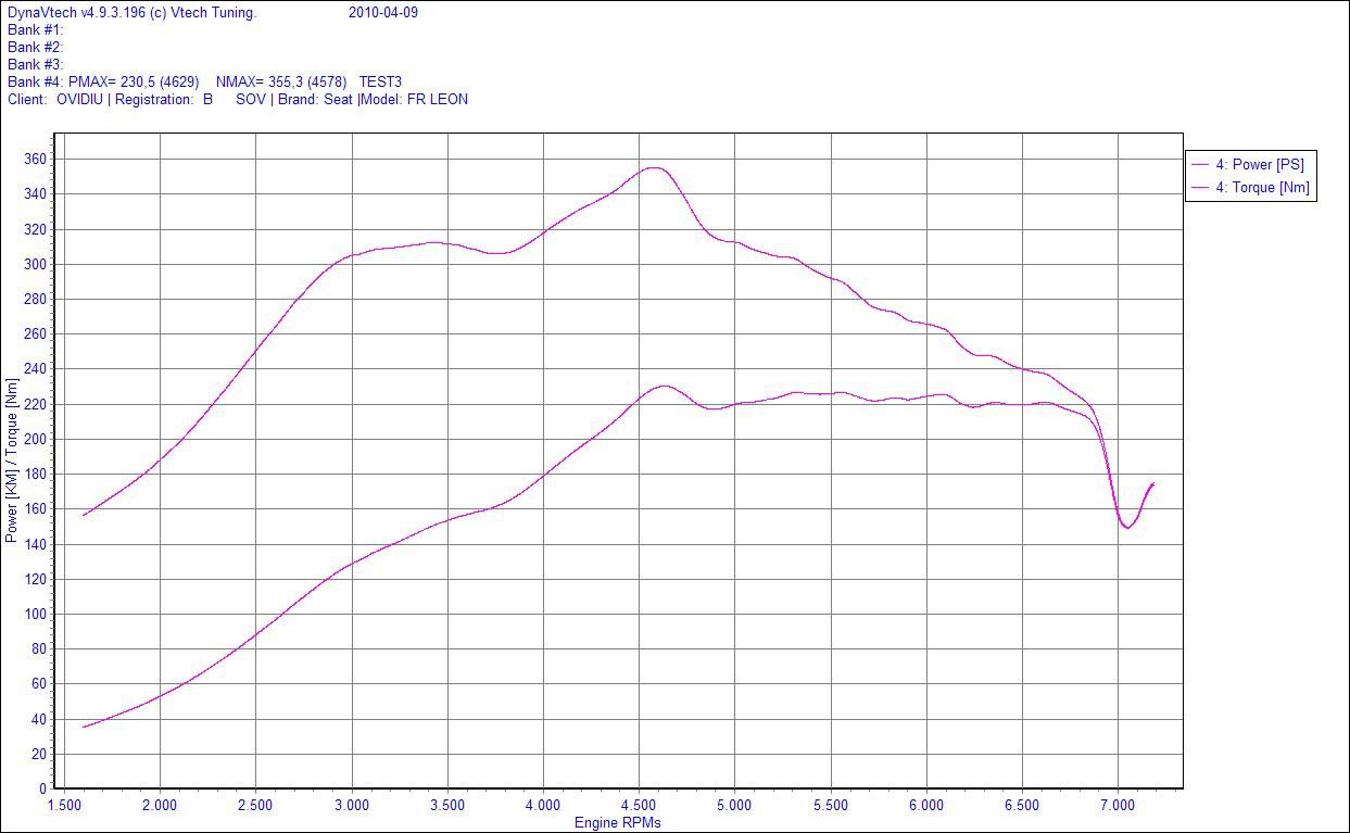

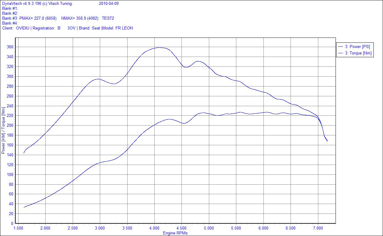

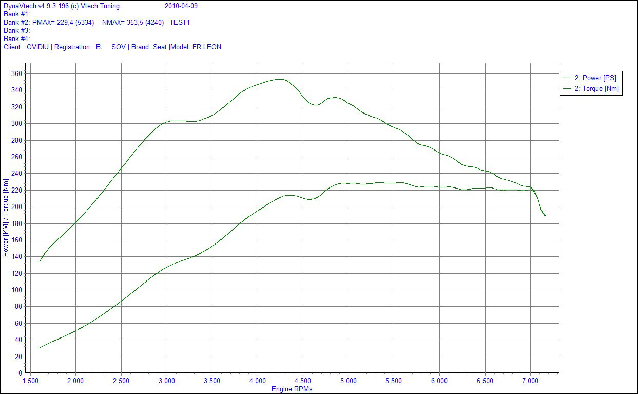

Revo stage 1 + BMC CDA.
Dyno neutru.
Si eu am FMIC, evacuare completa milltek, downpipe THS, inlet pipe forge, oil cooler, furtune siliconice forge... nu pot sa zic ca-s stock...
Azi o sa stiu ce si cum.. sa-mi tineti pumnii :Driver:
