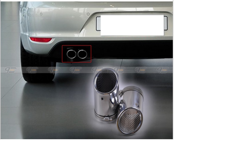

ma intereseaza niste ornamente din inox pentru evacuare si am gasit asa ceva la pret rezonabil:
post-124095-0-74240300-1422521504_thumb.
la specificatii zice:
2X STAINLESS STEEL EXHAUST TAIL REAR MUFFLER TIP PIPE For VW Passat B6 06-10 CC 08-12 EOS 06-12
  • Item name:2X STAINLESS STEEL EXHAUST TAIL REAR MUFFLER TIP PIPE For VW Passat B6 2006-2010 CC 08-12 EOS 06-12
  • Condition:100% new
  • Item included:
    exhaust pipe *2
Compatible:
Model: VW CC 2008-2012
VW EOS 2006-2012 (Gasoline only)
Passat B6  2006-2010 (Only fit the car with 2 Exhaust Pipe at the same side)
Features:
  • Made of high-grade 304 Stainless steel with injection molding technology, which offers a uniform thickness and shiny look.
  • No drilling or welding. Easy installation, No tools needed.
stie cineva ce diametru au tevile de la toba finala de la 1.9 tdi???
acestea au lungimea 1=14.50 cm    ;lungimea 2=10.50 cm    ;  diametru=7.40 cm

de pe un site din afara,nu merg pe Passat CC,au grilele diferite la proiectoare.
