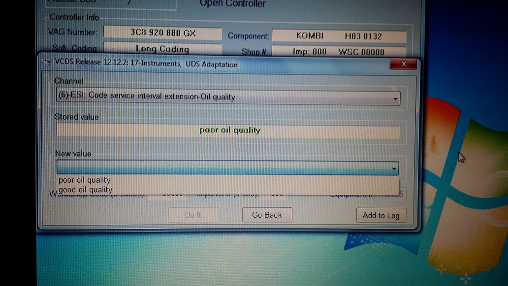

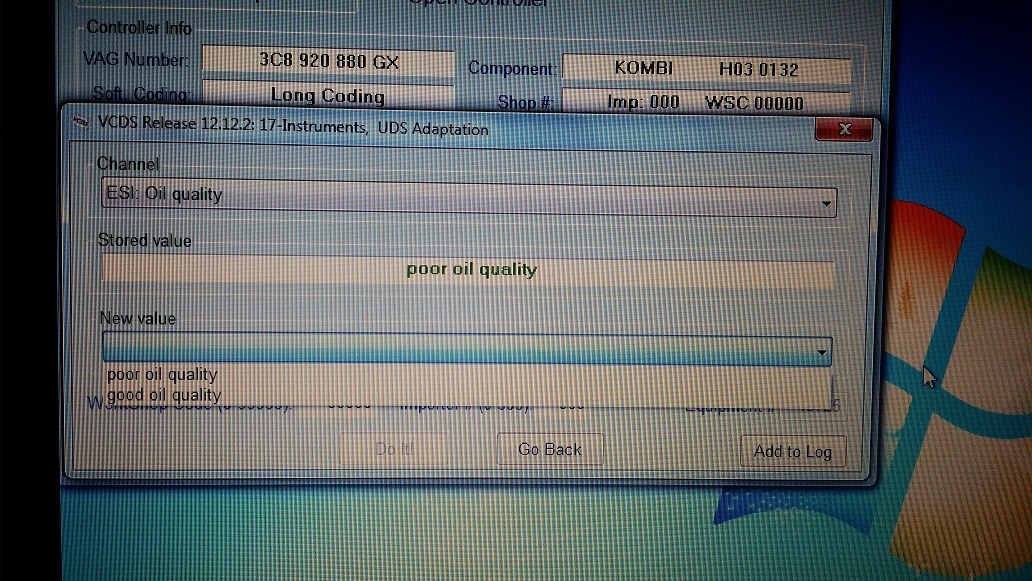

SERVICE NOW la ESI nu se reseteaza din bord, doar din VAG-COM.
Faci ce ti-am zis mai sus, megi la Oil Qualty, pui GOOD.
Si apoi ai RESET ESI, exact ca in link.
Si dupa aia e resetat.
Daca resetezi din bord, trece automat pe interval fix, 1an/15.000 sau 10.000km.

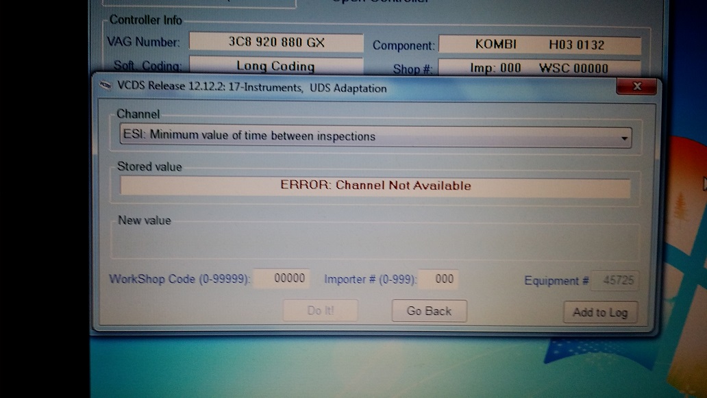

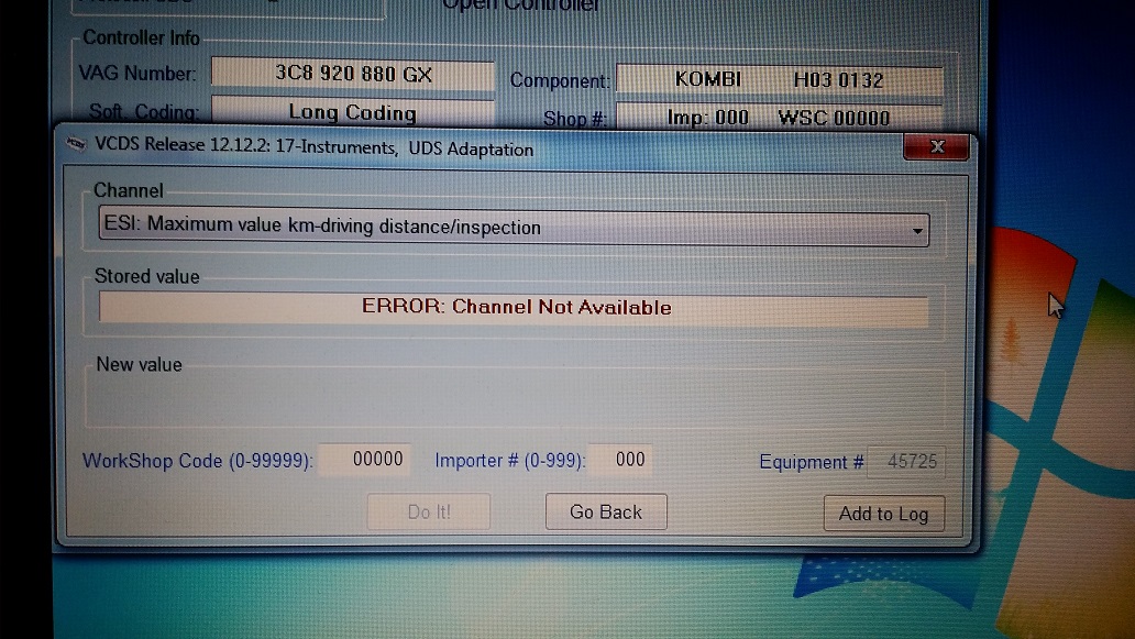

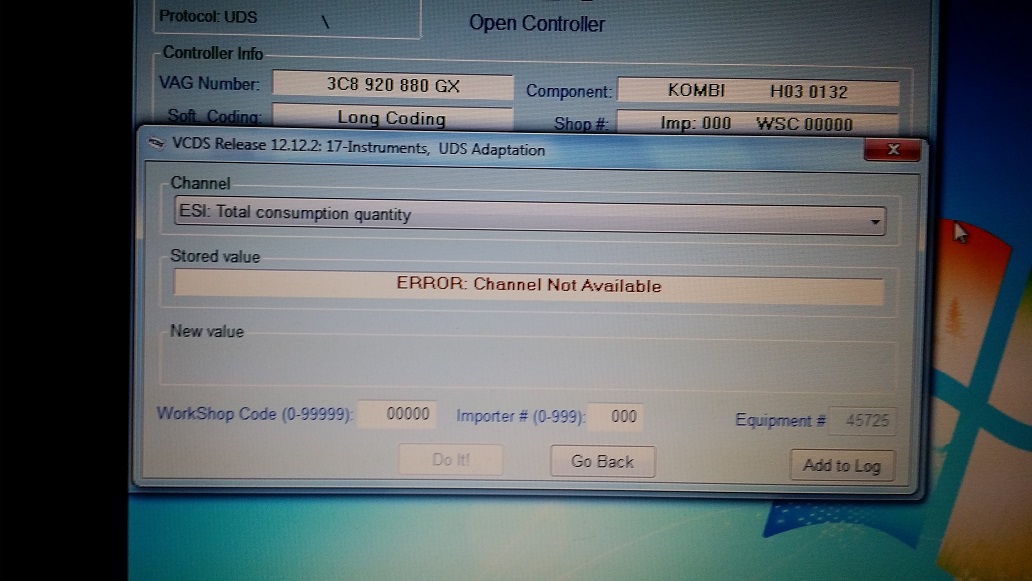

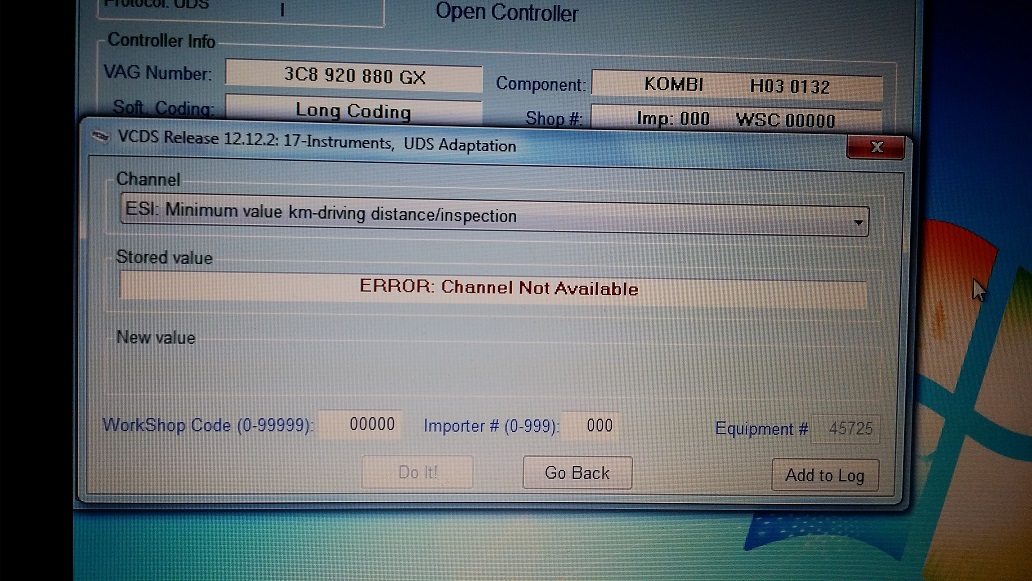

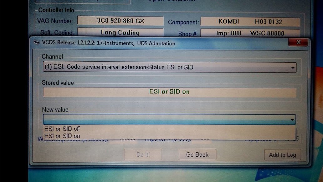

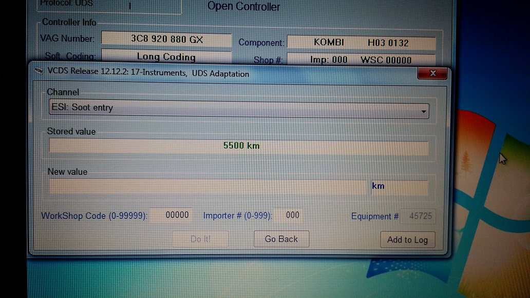

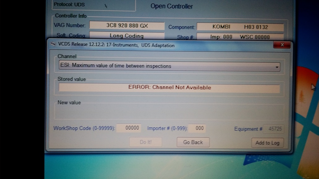

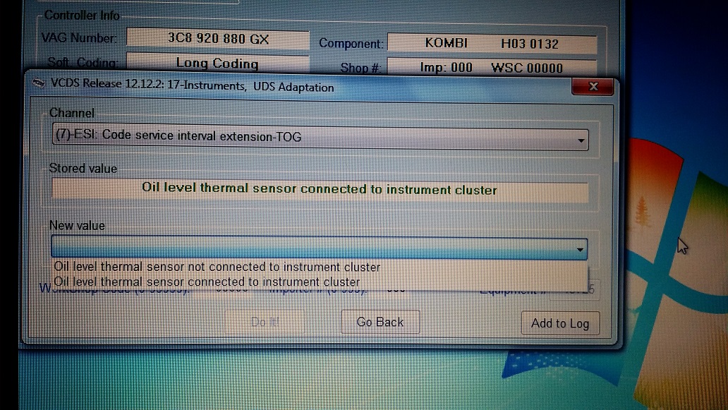

Sal.,

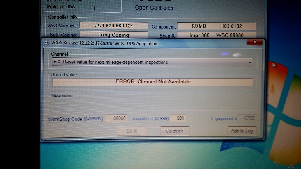

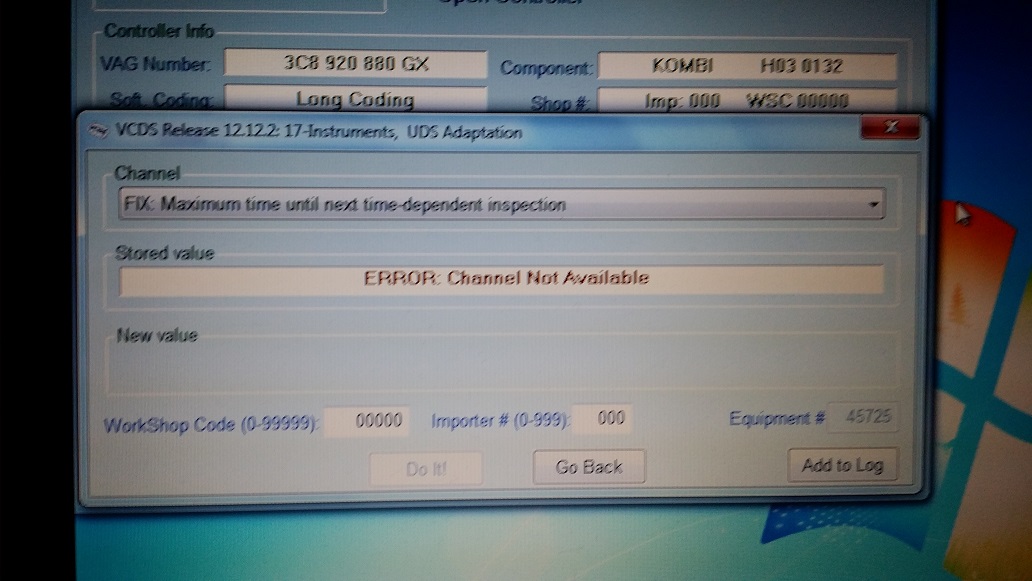

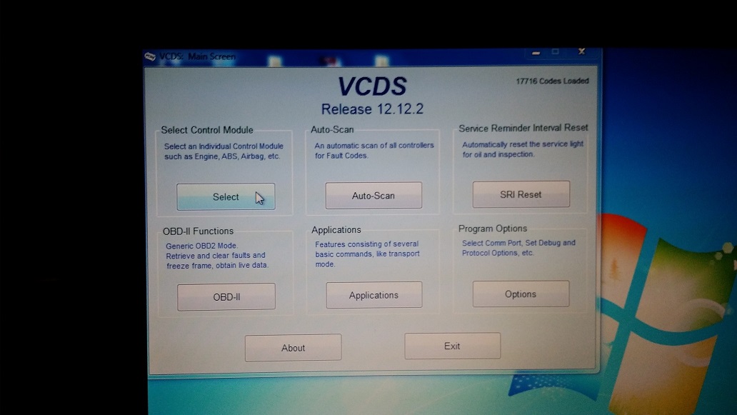

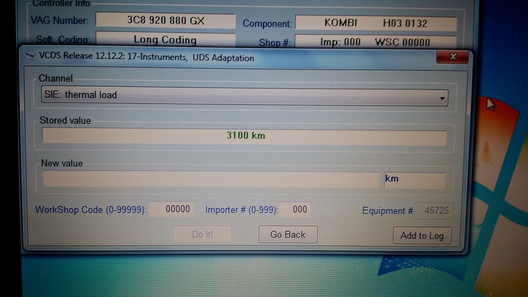

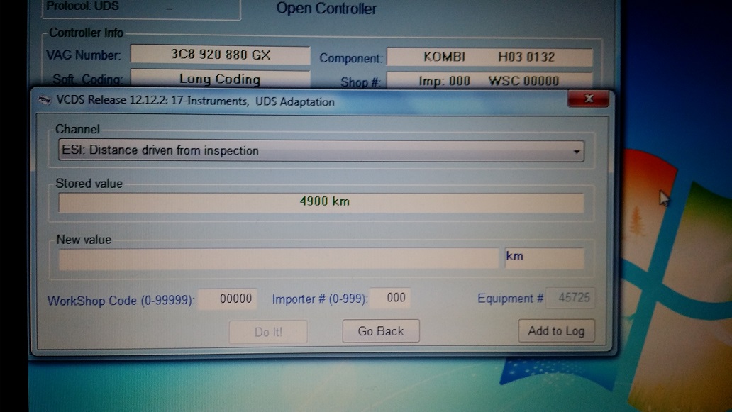

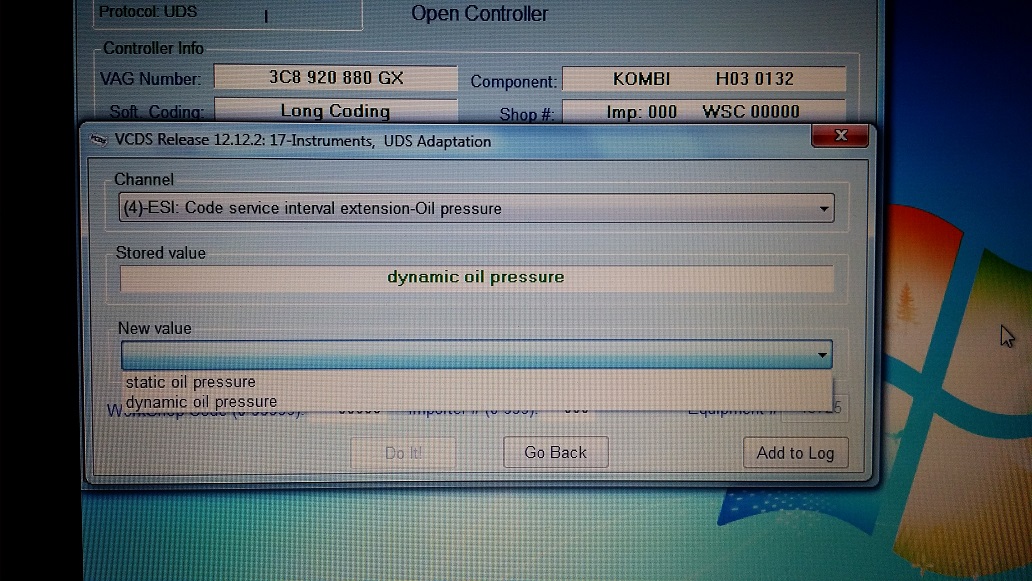

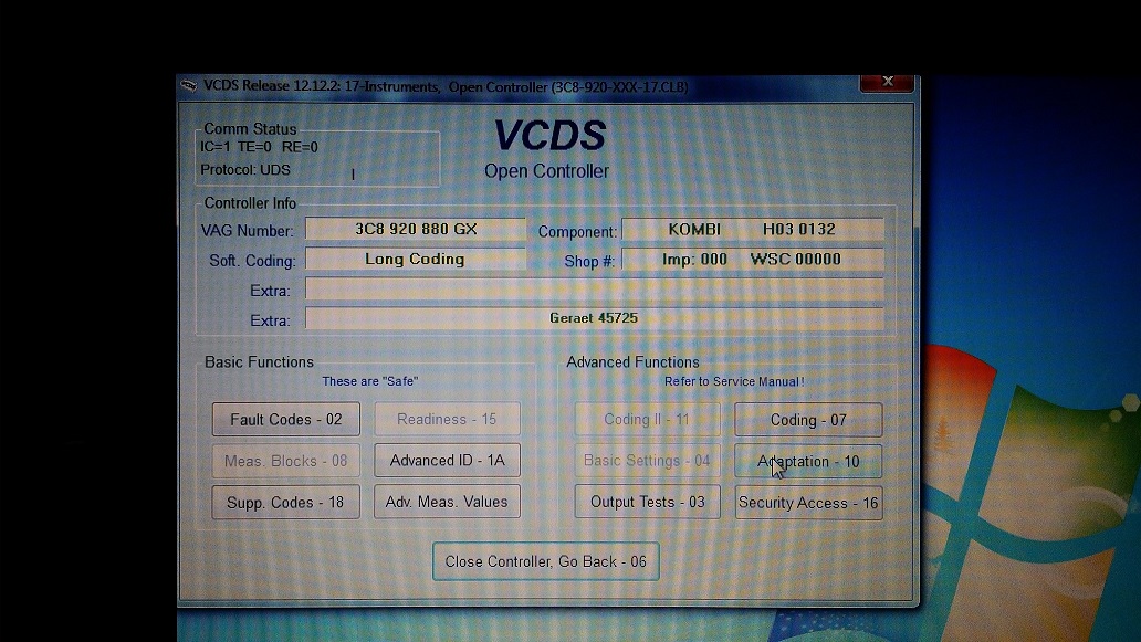

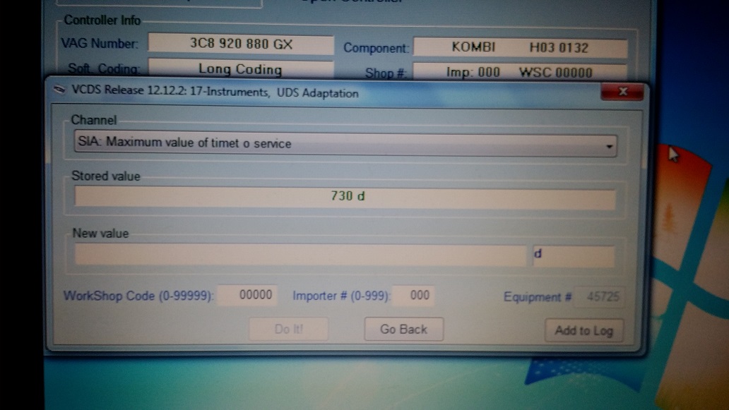

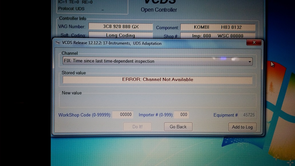

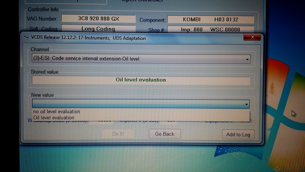

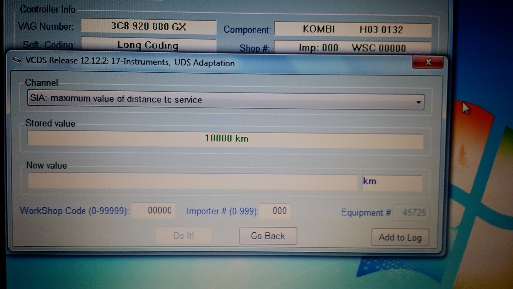

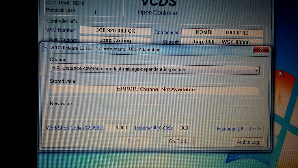

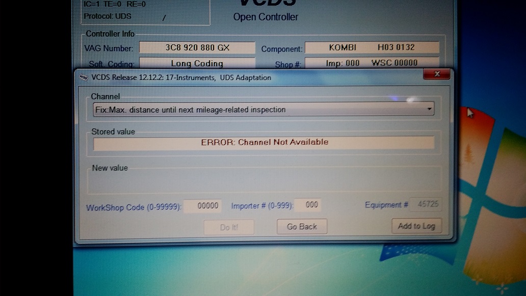

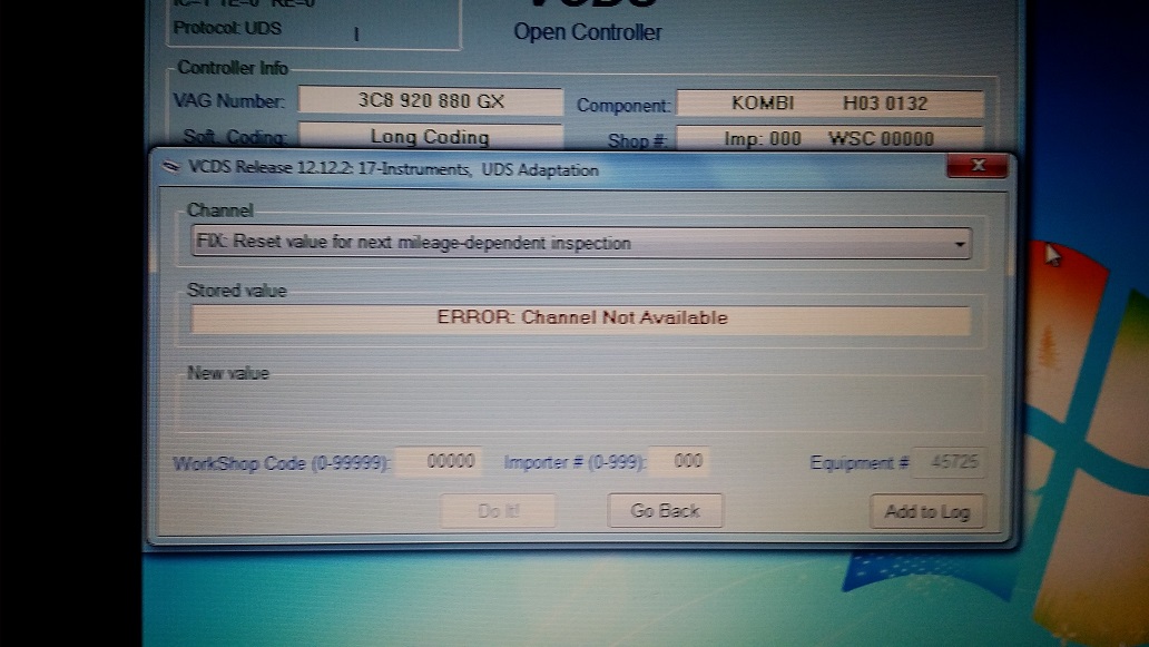

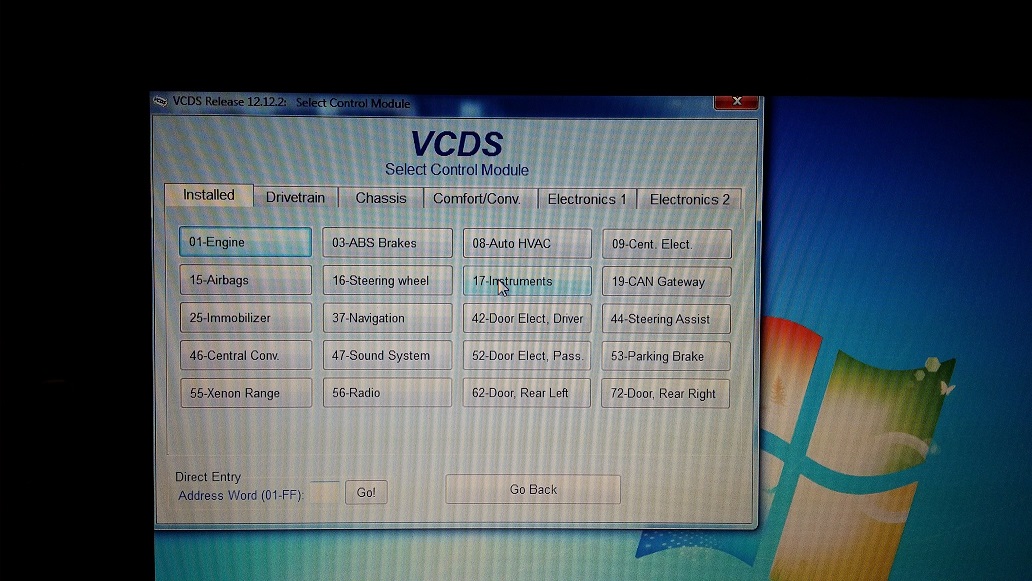

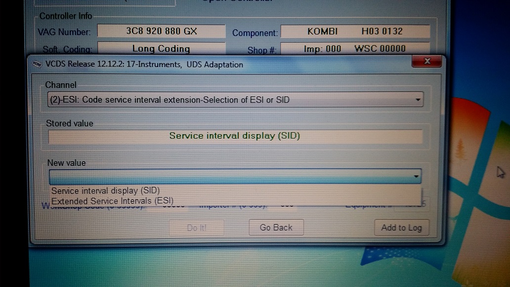

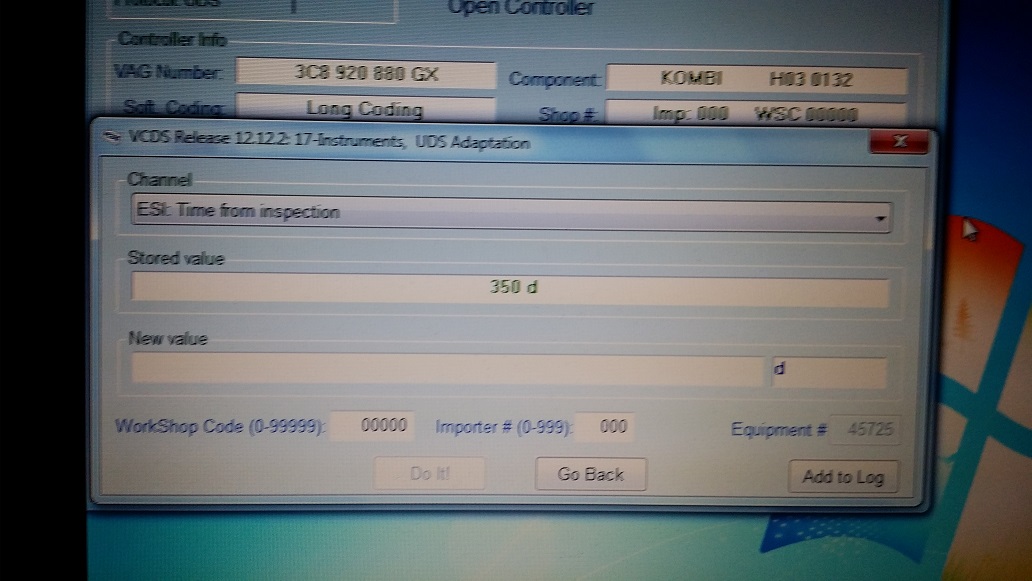

Uite pozele asa cum am promis .
A durat ceva ca a trebuit sa le mai micsorez .
post-20331-0-19306200-1403792681_thumb.j post-20331-0-49644000-1403792685_thumb.j post-20331-0-62715000-1403792691_thumb.j
post-20331-0-75032400-1403792709_thumb.j post-20331-0-71057200-1403792713_thumb.j post-20331-0-96498900-1403792717_thumb.j
post-20331-0-96089700-1403792735_thumb.j post-20331-0-90499200-1403792739_thumb.j post-20331-0-83306700-1403792746_thumb.j
post-20331-0-14678400-1403792952_thumb.j post-20331-0-20766800-1403792956_thumb.j post-20331-0-46398700-1403792964_thumb.j
post-20331-0-20099000-1403792994_thumb.j post-20331-0-36319500-1403793000_thumb.j post-20331-0-07908400-1403793006_thumb.j
post-20331-0-72626200-1403793028_thumb.j post-20331-0-75478100-1403793040_thumb.j post-20331-0-21493300-1403793050_thumb.j
post-20331-0-54567600-1403793133_thumb.j post-20331-0-36530200-1403793144_thumb.j post-20331-0-04877100-1403793156_thumb.j
post-20331-0-56162800-1403793172_thumb.j post-20331-0-80446000-1403793179_thumb.j post-20331-0-73311100-1403793186_thumb.j
post-20331-0-45791400-1403793211_thumb.j post-20331-0-06643800-1403793221_thumb.j post-20331-0-98491900-1403793229_thumb.j
post-20331-0-45588800-1403793254_thumb.j post-20331-0-32002600-1403793263_thumb.j
Astea sunt toate pozele cu interval-ul de service .
Te rog sa-mi zici ce si unde sa modific .
Poza X modifici din X in Y .
Dupa cum vezi in pozele 27 si 28 cu cei 10000 Km si cu cele 730 de zile am rezolvat .
Doar ca la mine apare in loc de :
"SID: maximum value of distance to service"
"SID: maximum value of time to service"
cum dau cei de la ROSS TECH
"SIA: maximum value of distance to service"
"SIA: maximum value of time to service"
asa cum se vede in poze .
Ce mai trebuie sa fac ca-mi arata in loc de 15 zile pana la service "SERVICE NOW " la punerea contactului .
Multumesc .
O zi buna .
Modificat de @DRI@N

- modifica din SID in ESI
- modifica in good oil quality
La final, dupa salvare, intri din nou si schimbi:
- resetting ESI: Reset
Bafta!
