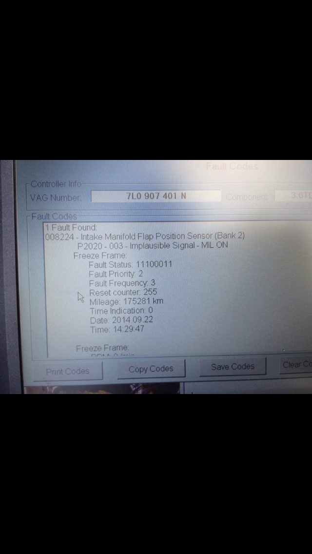

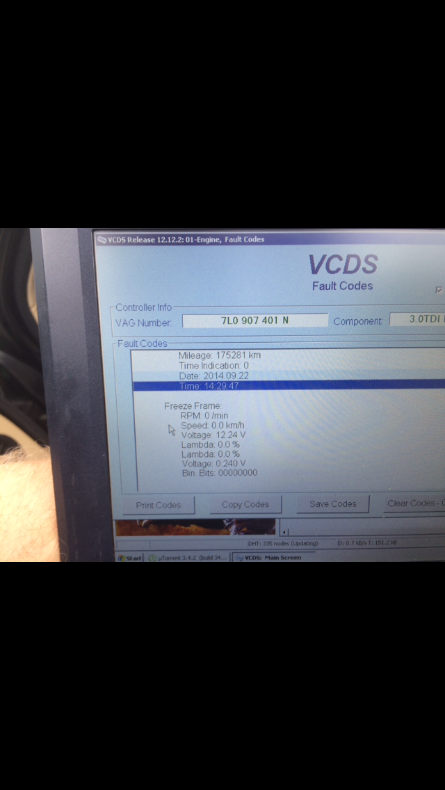

Buna seara ma confrunt cu urmatoarea problema la un touareg 2008, masina are un sunet (scartait) la acceleratie pana in 3000 rpm.post-30874-0-80060800-1411418907_thumb.p post-30874-0-90964700-1411418917_thumb.p
