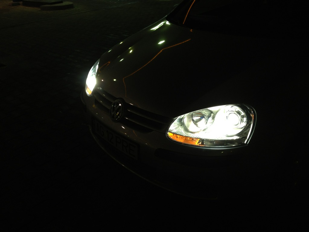

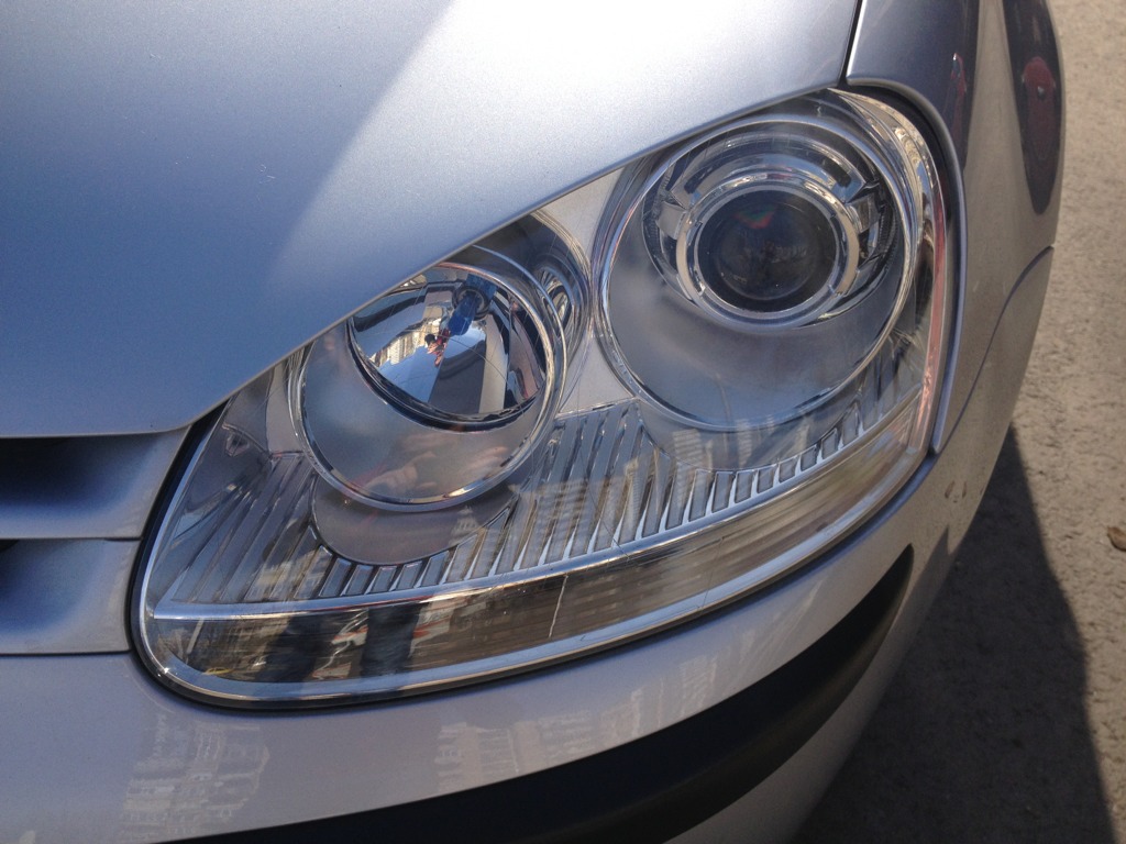

Pentru cei ce doriti lupe si xenon Mai puteti incerca varianta de a monta lupe in farurile originale, plus instalatie de xenon.Eu ma declar multumit de rezultat:post-21441-13601862985021_thumb.jpgpost-21441-13601863166364_thumb.jpgpost-21441-13601863259761_thumb.jpgpost-21441-13601863518105_thumb.jpgpost-21441-13601863679607_thumb.jpgpost-21441-13601863855301_thumb.jpgpost-21441-13601864004951_thumb.jpg
