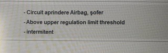

postez eroarea de la airbag.am mai curatat inca o data mufa, am sters eroarea insa imi apare a doua zi iar.
Saturday,04,April,2015,15:02:32:62939
VCDS Version: Release 12.12.0
                Address 15: Airbags       Labels: 1T0-909-605.lbl
Control Module Part Number: 1T0 909 605     HW: 1T0 909 605
  Component and/or Version: 05 AIRBAG VW62 0506 2112
           Software Coding: 0012341
            Work Shop Code: WSC 01324 785 00200
                      VCID: F2EBBC43ED5A7A8E127-80A7
1 Fault Found:
00588 - Airbag Igniter; Driver Side (N95)
            001 - Upper Limit Exceeded - Intermittent - MIL ON
