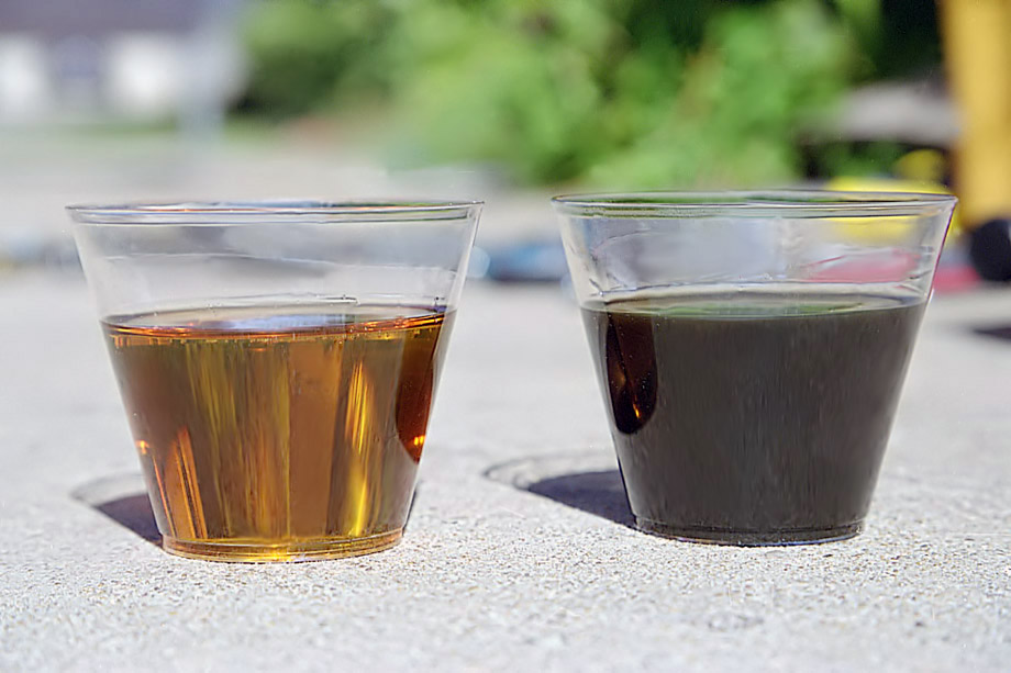

ULEIUL ERA SUPER NEGRU CRED CA AVEA MAI MULT DE 100 000 KM
PE MAGNETI AM GASIT CEVA PILITURA DAR NU DE SPERIAT !!
IN REST NIMIC DEOSEBIT,BUCATI DE METAL,ALUMINIU SAU ALTCEVA

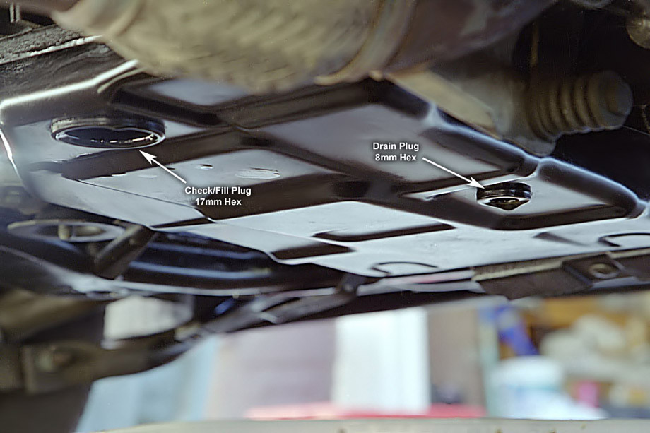

CAPACUL(BAIA) AM SPALAT CU DECARBOSOLV ,AM FACUT-O NOUA
LA TOATA OPERATIUNEA AM PARTICIPAT ACTIV ,
DATA VIITOARE O FAC SINGUR,ESTE ACEIASI OPERATIUNE CA PT ULEI L A MOTOR DECAT CA TREBUIE DATA BAIA JOS,SI SE UMPLE,PE JOS ,ASTA DACA AI SCULE ADICA O POMPITA CEVA
SE MAI POATE UMPLE SI PE LA CONDUCTA DE LA RADIATOR SE SCOATE DIN RADIATOR,SI CU UN FURTUN CU PALNIE ,UNU TOARNA UNU TINE,VOR INTRA CEI 6 LITRI MAI USOR,EU AM PREFERAT PE JOS DAR M-AM CHNUIT PUTIN,ASA DOAR CURETI PUI DOPURILE,SURUBURILE LE STRANGI BINE SI GATA,BAGI ULEI PE SUS,

CU FILTRU SCHIMBAT NU AM REUSIT SA INTRODUC IN CUTIE MAI MULT DE 5,8 l ULEI ,CHIAR SI CU MOTORUL PORNIT , ATATA INTRA ...................
DECI POANTA CU 9 l E O GLUMA PROASTA RAU

Usor OT : Am tot vazut pe forum ca oamenii se plang ca scot uleiul negru rau din cutie cand il schimba. Din ce-am vazut eu este perfect normal sa se ingraneasca (identic cu cel din motor). Schimbati-l si dupa 2-3000 km verificati-l. O sa fie la fel de negru.
