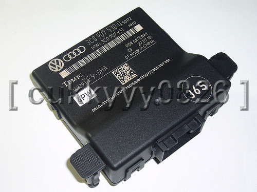

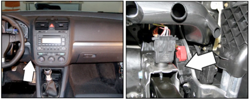

Din cate vad in scan-ul tau singura eroare stocata o ai pe modulul CAN.. Vezi ca ai un fir intrerupt. Verifca modulul respectiv. Este amplasat sub volan, deasupra pedalei de acceleratie si un pic dreapta.

Address 19: CAN Gateway Labels: 3C0-907-530.lbl
Part No SW: 3C0 907 530 A HW: 3C0 907 951 A
Component: Gateway 006 0010
Revision: 00006000 Serial number: 0500C052090172
Coding: 3D3D0C04CA1002
Shop #: WSC 05311 000 00000
VCID: 1F49E74FB57D
1 Fault Found:
00470 - Combination comfort Databus in Single Wire
011 - Open Circuit
