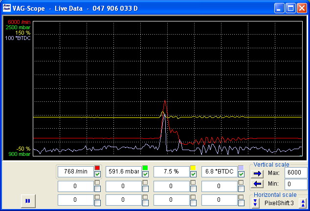

Fabia 1.4 MPI 44Kw, motor AZE, la pornire fluctueaza o perioada dupa care se stabilizeaza. La fel se intampla la accelerare. In momentul in care accelerez in prima faza turatii scade aproape de 400rpm apoi creste. Pe evacuare(toba) miroase a benzina nearsa. Plus urmatoarele erori:
VAG-COM Version: Release 311.2-N
Control Module Part Number: 047 906 033 D
Component and/or Version: 1,4l SIMOS3PB 00HSSJ31
Software Coding: 00021 Work Shop Code: WSC 13765
Additional Info: TMBPH16Y513205016
Faults Found:
17549 - Load Calculation Cross Check: Implausible Value P1141 - 35-00 - -
16556 - Fuel Trim: System Too Rich: Bank 1 P0172 - 35-00 - -
17658 - Fuel Level too Low P1250 - 35-00 - -
Am facut un graph pe turatie (rosu) si avans (mov).
