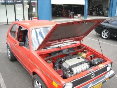

golf vr6 ... don't let this happen to you :

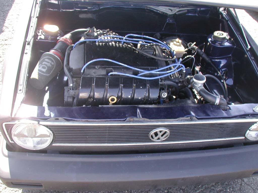

am mai gasit cativa iepuri vr6 :)
