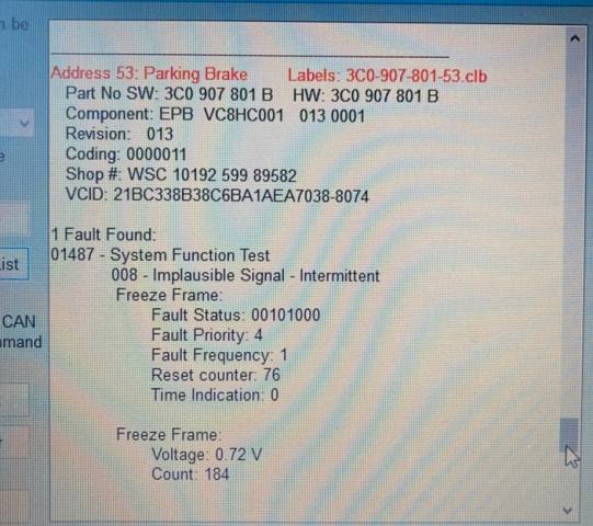

Am rugamintea daca ma poate aluta cineva cu aceasta eroare ce reprezinta .daca e grav si ce pot face.
Readiness: 0 0 0 0 0
Address 03: ABS Brakes Labels: 3C0-614-095-C2.lbl
Part No SW: 3C0 614 095 K HW: 3C0 614 095 K
Component: ESP 440 C2 H014 0001
Revision: H014 Serial number: 0648177830
Coding: 0013602
Shop #: WSC 01681 111 29999
1 Fault Found:
02839 - Wake-Up Line from Control Module for Electrical Parking Brake
008 - Implausible Signal - Intermittent
Freeze Frame:
Fault Status: 00101000
Fault Priority: 6
Fault Frequency: 1
Reset counter: 185
Time Indication: 0
