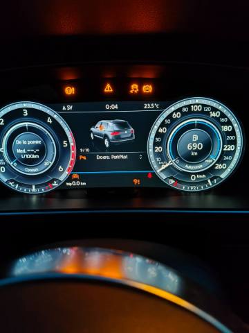

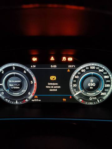

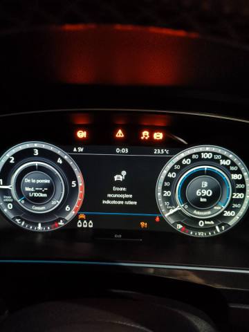

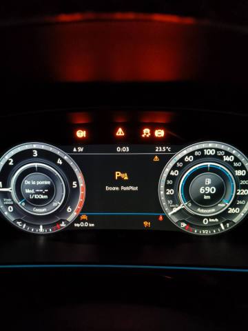

Buna Seara ! am un tiguan r line cumparat din Belgia acum doi ani  ! AZI, au aparut urmatoarele erori, toate dintr-o data, fara nimic inainte, la pornire !
aMAI INTALNIT CINEVA ASA CEVA ERORI .. SUNT 7 ERORI IN TOTAL
IMG20250715213619.thumb.jpg.72f64acae50a6b71865bb8d90945aa6a.jpg IMG20250715213532.thumb.jpg.5e7cd732fe15ca26477b79cc697b6fc8.jpgIMG20250715213518.thumb.jpg.000bb3e2340f2f714463569b293200ce.jpgIMG20250715213518.thumb.jpg.000bb3e2340f2f714463569b293200ce.jpg
Trebuie sa faci o diagnoza
F l o r i n
On 7/15/2025 at 9:56 PM, geo971 said:
Buna Seara ! am un tiguan r line cumparat din Belgia acum doi ani  ! AZI, au aparut urmatoarele erori, toate dintr-o data, fara nimic inainte, la pornire ! aMAI INTALNIT CINEVA ASA CEVA ERORI .. SUNT 7 ERORI IN TOTALIMG20250715213619.thumb.jpg.72f64acae50a6b71865bb8d90945aa6a.jpg IMG20250715213532.thumb.jpg.5e7cd732fe15ca26477b79cc697b6fc8.jpgIMG20250715213518.thumb.jpg.000bb3e2340f2f714463569b293200ce.jpgIMG20250715213518.thumb.jpg.000bb3e2340f2f714463569b293200ce.jpg
Fa o diagnoza cum ti-a recomandat Eexcalade, recomand cu Odis sau Vcds, sa te putem ajuta
