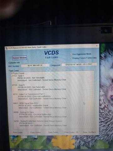

Salut, am o octavia 3 cu DQ250 6 trepte. Totul functioneaza absolut normal, doar ca am pus din intamplare un tester VCDS pe ea, sa vad daca exista ceva erori. Scanarea s-a efectuat cu bifa pusa pe " aggresive mode " nu stiu daca e ok. Am gasit o singura eroare pe cutie, cea cu selectorul.....
10763
Raw code: 002A0B
ECU: 02. Transmission control unit
Status: Test failed (current drive cycle)
Skoda: P173400: Starter release from the selector lever sensor system
Chiar daca totul functiona corect, am zis sa comand acel modul care rezolva aceasta problema, pentru a nu ajunge in situatia sa ramana cutia blocata in P sau altceva. Am comandat, montat la service care lucreaza cu skoda.
Toate bune si frumoase, eroarea a fost stearsa, de fata cu mine la service, si dupa aceea am decis sa mai pun eu o data VCDS acasa. Si au inceput sa curga erorile, dupa cum urmeaza, dar cutia schimba impecabil, nu smuceste, nu da vreun semn de " boala "
21153
Raw code: 0052A1
Skoda: Gear 1  P072C 00 - Not Selectable
============2==============
21154
Raw code: 0052A2
Skoda: Gear 2  P072D 00 - Not Selectable
============3==============
21155
Raw code: 0052A3
Skoda: Gear 3 P072E 00 - Not Selectable
============4==============
21156
Raw code: 0052A4
Skoda: Gear 4  P072F 00 - Not Selectable
============5==============
21157
Raw code: 0052A5
Skoda: Gear 5 P073A 00 - Not Selectable
============6==============
21159
Raw code: 0052A7
Skoda: Gear R P072B 00 - Not Selectable
============7==============
10731
Raw code: 0029EB
Skoda: P174A00: Valve 3 in partial transmission 1
Electrical error
Skoda: Valve 3 in Transmission Part 1 P174A 00 - Electrical malfunction
============8==============
10732
Raw code: 0029EC
Skoda: P174E00: Valve 3 in partial transmission 2
Electrical error
Skoda: Valve 3 in Transmission Part 2  P174E 00 - Electrical malfunction
============9==============
10906
Raw code: 002A9A
Skoda: P179D00: Cooling oil valve
Electrical error
Skoda: Cooling Oil Valve P179D 00 [002] - Electrical Malfunction
============10==============
10763
Raw code: 002A0B
Va rog daca ma puteti ajuta cu un sfat sau o rezolvare, v-as fi recunoscator. Multumesc mult.

De fapt cu Agressive Mode bifat. Dar, având în vedere ca e un post vechi de mai bine de un an, nu cred ca mai asteapta răspuns.
bogdand2009
1 minut în urmă, F l o r i n a scris:
ai dreptate, am inlocuit selectorul acela dar fara sa fie nicio problema, nu am stiut, am scanat cu agresive mode, si m-am panicat :) . Banuiesc ca nu deranjeaza cu nimic daca am cumparat ala original si l-am montat . multumesc de raspuns
F l o r i n
Nu, nu are treaba.... e ok.
