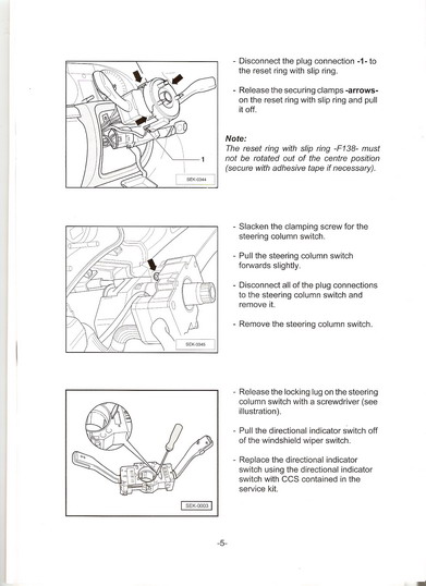

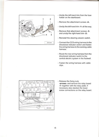

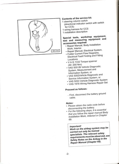

Instructiunile de montare cruise control ( si adaptare VagCom pentru Golf / Bora TDI ) .
post-7729-1171129898_thumb.jpgpost-7729-1171129907_thumb.jpgpost-7729-1171129917_thumb.jpgpost-7729-1171129930_thumb.jpg
post-7729-1171129984_thumb.jpgpost-7729-1171129995_thumb.jpgpost-7729-1171130004_thumb.jpgpost-7729-1171130040_thumb.jpg
post-7729-1171130051_thumb.jpgpost-7729-1171130061_thumb.jpgpost-7729-1171130069_thumb.jpgpost-7729-1171130074_thumb.jpg
Enjoy boys ! :P
