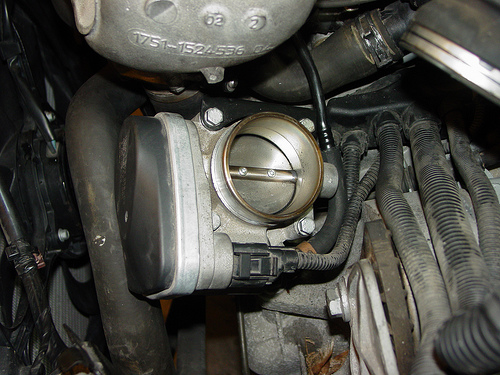

Sal imi spune si mie cineva unde se afla piesa asta???
Control Module Part Number: 036 906 014 AB
Component and/or Version: MARELLI 4AV 2445
Software Coding: 00000
Work Shop Code: WSC 00000
1 Fault Found:
00282 - Throttle Position Actuator (V60)
26-10 -- Output Open - Intermittent
Clapeta de acceleratie.
sa iti faci o idee, seamana cu :
