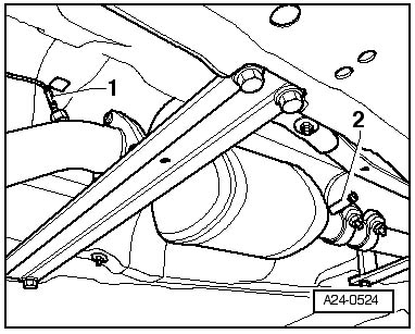

eroarea 17479,se refera la contacte imperfecte la sonda lambda,de dupa catalizator?am vreo sansa sa scap daca curat contactele?
Salut
Da...cam asta ar fi
error code : 17479 P1071
NOx sensor (G295) heating control signal implausible signal
Additional information on the error codes. Intermittent
Possible causes:
* Wiring and / or connections
* G295
Modificat de cuiuda
