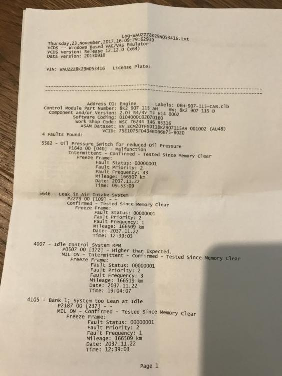

Salut .
Acum cateva zile eram cu masina prin oras si la un moment dat imi apare mesajul “Switch Engine Off and check engine oil level” si cum eram aproape de ceva service si schimbul de ulei trebuia sa il fac oricum pt ca trecuse un an ( dar am facut doar 3000 km in acest timp ) am oprit si am schimbat uleiul si filtrele de ulei , aer si polen . M-am plimbat apoi putin cu ea si am avut din nou mesajul initial fapt care m-a decis sa pun Vagul pe ea si am gasit urmatoarele erori (cred ca cei de la service nu au sters eroriile ) :
5582- oil pressure switch for reduced oil pressure
P2642D 00 - Malfunction
5646 -Leak in air intake system
P2270 00 [109]
4007 - Idle Control System RPM
P0507 00 [172]- Higher than expected
4105-Bank 1 : System too lean at IDLE
P2187 00 [237]
Cu ulei schimbat (4.6 L)  seara am sters erorile de mai sus si a doua zi am mai mers putin cu masina prin oras fara sa imi mai apara nimic in bord si la sfarsit am facut un scan si am gasit urmatoare eroare:
Address 01: Engine Labels: 06H-907-115-CAB.clb
Control Module Part Number: 8K2 907 115 AH HW: 8K2 907 115 D
Component and/or Version: 2.0l R4/4V TF H14 0002
Software Coding: 0104000C02070160
Work Shop Code: WSC 76244 146 85316
ASAM Dataset: EV_ECM20TFS0118K2907115AH 001002 (AU48)
VCID: 75E1075FD434EDB6B75-8020
1 Fault Found:
5646 - Leak in Air Intake System
P2279 00 [039] - -
Not Confirmed - Tested Since Memory Clear
Freeze Frame:
Fault Status: 00000001
Fault Priority: 2
Fault Frequency: 1
Mileage: 166546 km
Pareri?
