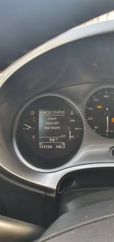

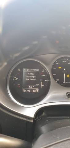

Buna ziua si salutare dragilor,
Ma confrunt cu o problema nu foarte grava dar daca se poate remedia as fi multumit.
Am un seat leon 1P din 2011 1.4 TSI .
Mi am montat becuri cu led pe faza scurta, in bord imi da eroare de bec ars pana ce le aprind si sesizeaza consumul astfel eroarea dispare. Am cautat si pe prietenul nostru google cum ca adaptarea se face de acolo si nu din alt modul de confort , nu am gasit la modelul meu de centrala electrica calea de a intrat cu vagul si a dezactiva bitii care corespund faza scurta stanga ( RB1 ) si faza scurta dreapta ( LC5 ) , codul de securitate de a putea activa adaptarile extra nu se potriveste si tot asa ?
Care ar fi calea de rezolvare ?
Mai jos las si modelul centrala electrica ce imi apartine la seatul meu si erorile de rigoare.
Address 09: Cent. Elect. (J519)       Labels:. 1K0-937-08x-09.clb
   Part No SW: 5K0 937 086 J    HW: 5K0 937 086 J
   Component: BCM PQ35 M    011 0048
   Revision: BC011001
   Coding: 42180A3E803708C0428800809500810442519DA8527D89605C8040000040
   Shop #: WSC 04941 123 12345
   VCID: 3B7F6A2FBA65A792C0-806E
   Subsystem 1 - Part No: 1P0 955 119 C  Labels: 1KX-955-119.CLB
   Component: Wischer 27041  22  0611
   Coding: 00DB90
   Subsystem 2 - Part No SW: 1P0 955 559 A    HW: 1P0 955 559 A  Labels: 1P0-955-559.CLB
   Component: REGENLICHTSEN  H04 0003
   Coding: 02542E
2 Faults Found:
00978 - Lamp for Low Beam; Left (M29)
            010 - Open or Short to Plus
             Freeze Frame:
                    Fault Status: 01101010
                    Fault Priority: 1
                    Fault Frequency: 1
                    Reset counter: 154
                    Mileage: 171724 km
                    Time Indication: 0
                    Date: 2015.07.18
                    Time: 13:24:46
             Freeze Frame:
                        Term 15 On
                    Voltage: 12.10 V
                        ON
                        ON
                        OFF
                        OFF
                        OFF
00979 - Lamp for Low Beam; Right (M31)
             Freeze Frame:
                    Fault Priority: 1
                    Fault Frequency: 1
                    Reset counter: 154
                    Mileage: 171724 km
                    Time Indication: 0
                    Date: 2015.07.18
                    Time: 13:24:46
             Freeze Frame:
                        Term 15 On
                    Voltage: 12.10 V
                        ON
                        ON
                        OFF
                        OFF
                        OFF
Orice raspuns este binevenit , multumesc anticipat.
Ionut.
