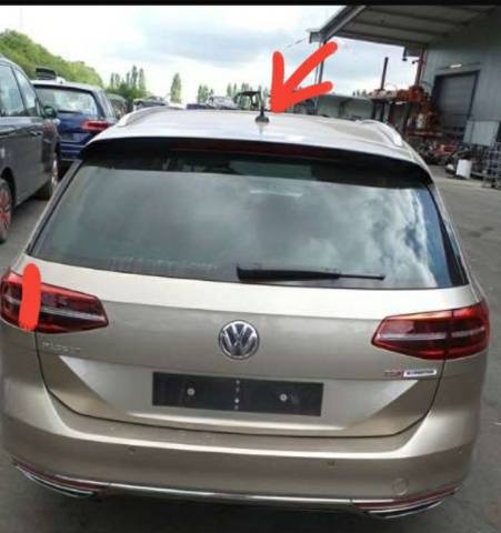

E break masina , e in spate ?

Pe plafon, in spate. Noua originala, de plafon, cred ca in jurul la 1200 lei.....noua aftermarket,  de ascuns sub bord...100 lei.
