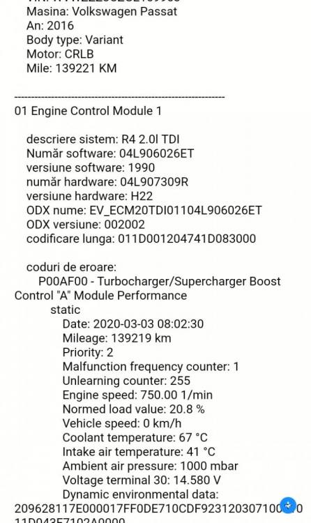

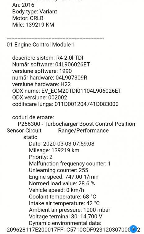

Sa inteleg ca trebuie schimbat actuatorul?
Vezi daca vine vacuum la actuator si daca actuatorul tine vacuum
