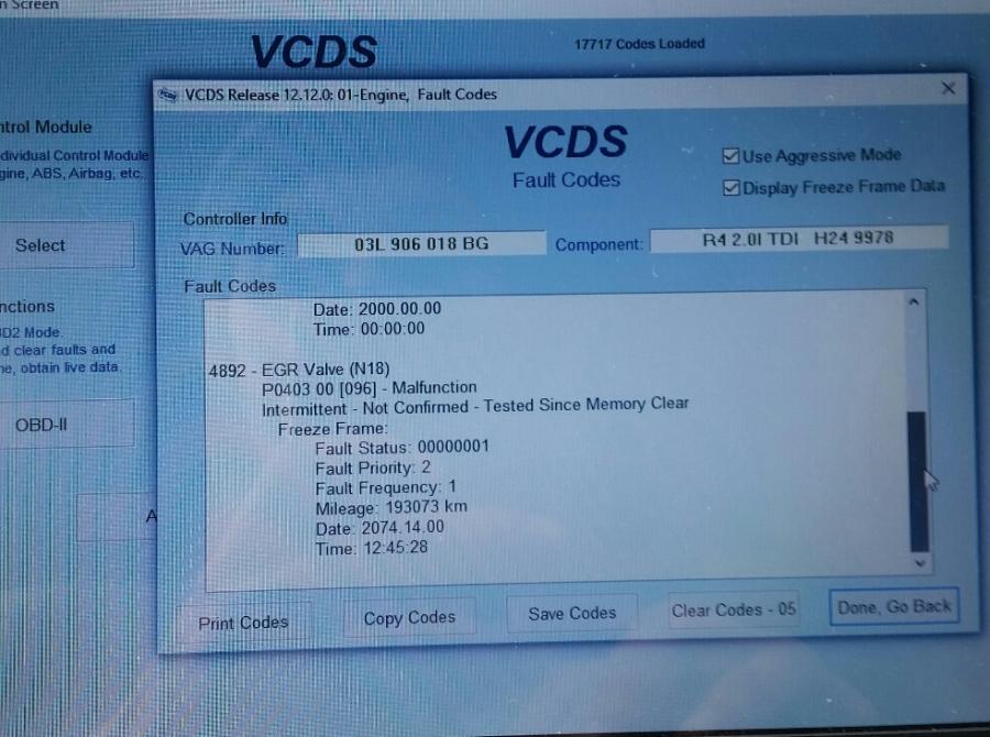

Va rog mult o interpretare si un sfat in cazul de mai jos ........Multumesc anticipat
Address 01: Engine (J623-CFFB)       Labels: 03L-906-018-CFF.clb
   Part No SW: 03L 906 018 BF    HW: 03L 907 309 N
   Component: R4 2.0l TDI   H24 9978
   Revision: 47H24---    Serial number: 00000000000000
   Coding: 00190012041401080000
   Shop #: WSC 29100 002 1048576
   ASAM Dataset: EV_ECM20TDI01103L906018BF 003008
   ROD: EV_ECM20TDI01103L906018BE.rod
   VCID: 6FE7CBFCB663CD667D9-803A
2 Faults Found:
4891 - EGR Valve (N18)
          P0403 00 [104] - Malfunction
          Intermittent - Confirmed - Tested Since Memory Clear
             Freeze Frame:
                    Fault Status: 00000001
                    Fault Priority: 2
                    Fault Frequency: 9
                    Mileage: 291047 km
                    Date: 2030.14.02
                    Time: 13:22:09
5286 - Throttle Position Sensor (G69)
          P0121 00 [237] - Implausible Signal
          MIL ON - Confirmed - Tested Since Memory Clear
             Freeze Frame:
                    Fault Priority: 2
                    Fault Frequency: 11
                    Mileage: 292727 km
                    Date: 2031.14.00
                    Time: 11:32:15
Readiness: 1 2 0 0 0
Address 08: Auto HVAC (J255)       Labels: 5K0-907-044.clb
   Part No SW: 5K0 907 044 EA    HW: 5K0 907 044 EA
   Component: Climatronic   H17 1010
   Revision: 00003001
   Coding: 0000000003
   Shop #: WSC 00015 115 00000
   ASAM Dataset: EV_Climatronic A01010
   ROD: EV_ClimaAutoBasis_SE36.rod
   VCID: 6ED9D6F8B169C46E76F-803B
1 Fault Found:
9481988 - Air Quality Sensor
          B10AF 04 [009] - Internal System Fault
             Freeze Frame:
                    Fault Priority: 3
                    Fault Frequency: 254
                    Reset counter: 122
                    Mileage: 289395 km
                    Date: 2028.14.28
                    Time: 11:11:39
 Martorul apare in bord cel cu motor apare din senin,dispare dupa ce opresc motorul,,,apare iar dupa cateva zile si tot asa.La masina totul pare ok motorul trage fara probleme.
Ai erori legate de EGR si aerul conditionat, pe EGR ai un comportament tipic legat de uzura, sporadic raspunde lent la comenzile de deschidere, probabil ve vor inmulti aparitiile, daca durata in care nu se adaptaza comenzii din ecu creste, vei avea spira aprinsa permanent, eventual si martorul engine si motorul va functiona cu limitarea in turatie. Pe aerul conditionat ai senzorul de calitate a aerului vazut ca defect, filtrul e curat?

Multumesc ptr raspuns    .Referitor la filtru nu stiu daca e curat sau nu,mai am 1500 km pana la urmatorul schimb.Atunci am sa verfific acest lucru
Se inlocuieste egr-ul si se curata clapeta.
Problema trebuie remediata urgent altfel se colmateaza dpf-ul

Daca eroarea apare iar egr-ul trebuie inlocuit cu unul nou oe.
Se colmateaza dpf-ul daca mergi cu eroarea activa
