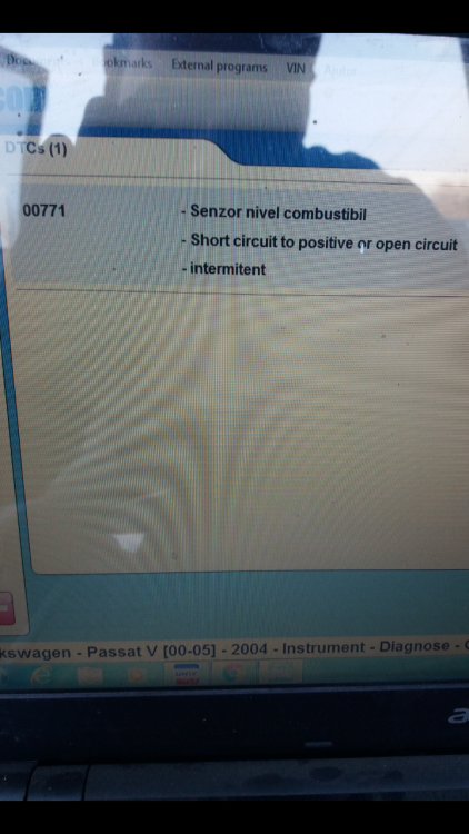

Revin cu un update la problema mea cu insuficient flow la egr,problema s-a rezolvat prin schimbarea electrovanei egr.Din pacate tot nu pot regenera filtrul de particule pt ca am o noua eroare:
Address 17: Instruments       Labels: 4F0-910-xxx-17.lbl
Control Module Part Number: 4F0 910 930 A    HW: 4F0 920 931 F
  Component and/or Version: KOMBIINSTR. M73 H16 0630
           Software Coding: 2049043
            Work Shop Code: WSC 11111 111 11111
                      VCID: 2149030FF83C3116BBD-8074
1 Fault Found:
00771 - Fuel Level Sensor (G)
            010 - Open or Short to Plus
             Freeze Frame:
                    Fault Status: 01101010
                    Fault Priority: 7
                    Fault Frequency: 2
                    Reset counter: 108
                    Mileage: 210920 km
                    Time Indication: 0
                    Date: 2017.03.18
                    Time: 15:06:58
Am verificat in instrumente si am urmatoarele date:
Address 17: Instruments  (4F0 910 930 A)
11:19:54
  0.0 l   Tank Content
  141   Fuel Gauge Sender 2
  131   Fuel Gauge Sender 1
  --   Fuel Sender 1 (Resistance)
  0.0 l   Fuel Sender 1 (Tank Content)
  87   Fuel Sender 2 (Resistance)
  50.2 l   Fuel Sender 2 (Tank Content)
Ce ar trebui sa fac mai departe?
