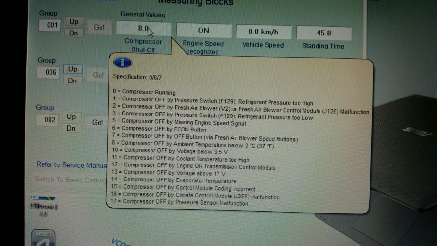

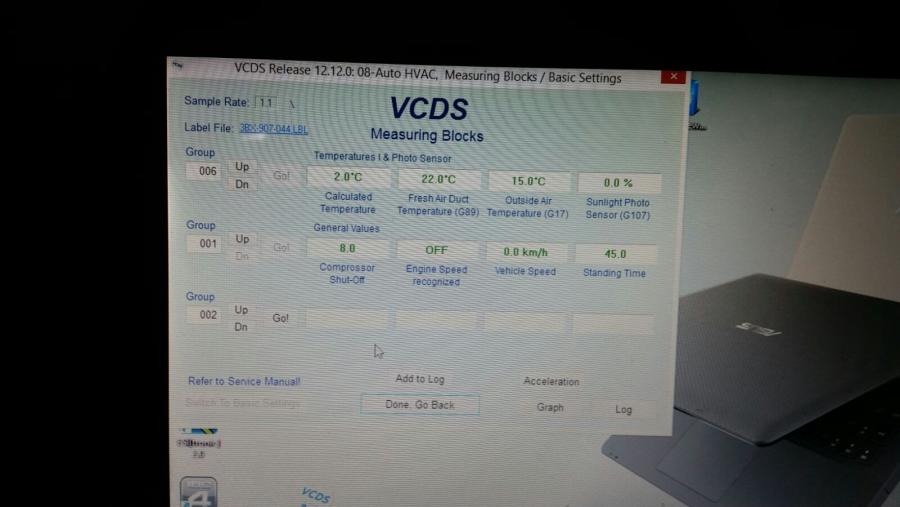

va salut.ma confrunt cu o mica problema.un g4 climatronic.
incarcata instalatia cu freon(cu robot) dar tot nu porneste.
a se vedea conditia de decuplare.
de unde si pana unde calculeaza clima cele 2°c?!
senzorul din bara fctioneaza,il incing cu aer cald si valoarea ii creste.
am scos si bornele,am facut refresh la coding....degeaba...nimik.la fel,nu pleaca compresorul.
gata.caz rezolvat.
"Display will not change when road speed is below
15 km/h (9.5 mph) and coolant temperature is above
70C (158F). Under these conditions, the actual
measured value is not displayed because engine
heat will adversely affect reading."
