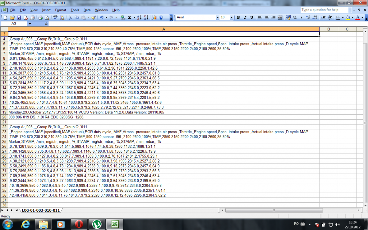

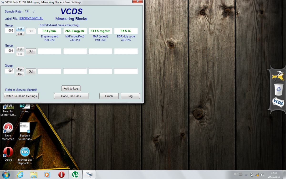

Poate cineva sa-mi interpreteze si mie logo facut, si sa-mi dea un sfat (VW Bora 2002)-EroareCharge Pressure Control Pozitive Deviation
Sunday,21,October,2012,19:35:28 038 906 019 FF,,1.9l R4 EDC G000AG 1449, ,Group A:,'003,,,,Group B:,'010,,,,Group C:,'011 ,,Engine speed,MAF (specified),MAF (actual),EGR duty cycle,,MAF,Atmos. pressure,Intake air press.,Throttle,,Engine speed,Spec. intake press.,Actual intake press.,D.cycle MAP ,TIME,790-870,230-310,210-350,50-70%,TIME,800-1100,sensor -f96-,1900-2150,100%,TIME,2850-3150,1900-2150,1900-2150,55-75% Marker,STAMP, /min, mg/str, mg/str, %,STAMP, mg/str, mbar, mbar,%,STAMP, /min, mbar, mbar, % ,0.01,1092,230.0,494.9,84.5,0.36,485.1,1009.8,1142.4,0.0,0.76,1050,1030.2,1142.4,24.7 ,1.16,1113,355.0,504.7,84.5,1.56,514.5,1009.8,1173.0,7.5,1.96,1113,1050.6,1193.4,24.7 ,2.34,1365,800.0,519.4,4.8,2.74,558.6,1009.8,1295.4,72.9,3.12,1848,2152.2,1479.0,21.1 ,3.52,2079,735.0,617.4,4.8,3.92,705.6,1009.8,1744.2,45.5,4.32,2226,2254.2,1846.2,43.8 ,4.74,2352,830.0,617.4,4.8,5.14,646.8,1009.8,2050.2,50.6,5.55,2373,1295.4,2029.8,88.1 ,5.97,2352,440.0,847.7,84.5,6.37,793.8,1009.8,1897.2,25.9,6.78,1596,1091.4,1530.0,69.7 ,7.16,1575,230.0,490.0,84.5,7.58,485.1,1009.8,1122.0,0.0,7.98,1512,999.6,1081.2,73.3 ,8.38,1470,230.0,465.5,84.5,8.78,475.3,1009.8,1050.6,0.0,9.16,1386,999.6,1071.0,51.0 ,9.56,1344,230.0,490.0,84.5,9.96,514.5,1009.8,1122.0,0.0,10.36,882,999.6,1122.0,24.7 ,10.76,861,250.0,475.3,84.5,11.14,475.3,1009.8,1111.8,0.0,11.54,903,1071.0,1101.6,24.7 ,11.94,1323,610.0,480.2,37.9,12.34,568.4,1009.8,1193.4,23.1,12.74,1239,1142.4,1295.4,43.4 ,13.12,1260,355.0,558.6,59.8,13.52,543.9,1009.8,1295.4,7.1,13.92,1260,1009.8,1264.8,59.0 ,14.32,1239,245.0,524.3,84.5,14.72,514.5,1009.8,1234.2,2.0,15.10,1197,999.6,1213.8,37.1 ,15.50,1155,230.0,509.6,84.5,15.90,499.8,1009.8,1183.2,2.0,16.30,1092,999.6,1173.0,24.7 ,16.70,1071,280.0,504.7,84.5,17.10,499.8,1009.8,1162.8,10.2,17.50,1260,1101.6,1183.2,24.7 ,17.88,1260,470.0,543.9,84.5,18.28,543.9,1009.8,1254.6,0.0,18.68,840,999.6,1203.6,35.9 ,19.08,819,265.0,485.1,84.5,19.48,485.1,1009.8,1142.4,0.0,19.88,819,999.6,1122.0,33.1 ,20.27,819,265.0,465.5,84.5,20.66,470.4,1009.8,1101.6,0.0,21.06,819,999.6,1101.6,24.7 ,21.46,819,280.0,480.2,84.5,21.84,480.2,1009.8,1101.6,0.0,22.24,819,999.6,1101.6,24.7 ,22.64,819,280.0,460.6,84.5,23.04,485.1,1009.8,1101.6,16.1,23.44,1029,999.6,1142.4,24.7 ,23.84,903,745.0,455.7,29.9,24.23,509.6,1009.8,1152.6,69.8,24.62,1512,1734.0,1254.6,28.7 ,25.02,1722,835.0,597.8,4.8,25.42,617.4,1009.8,1540.2,82.4,25.82,1911,2233.8,1672.8,22.3 ,26.21,1995,850.0,578.2,4.8,26.63,578.2,1009.8,1754.4,81.2,27.05,2163,2080.8,1785.0,29.9 ,27.46,2247,855.0,548.8,4.8,27.86,558.6,1009.8,1805.4,67.8,28.27,1743,2019.6,1785.0,19.9 ,28.66,1848,850.0,627.2,4.8,29.06,735.0,1009.8,1825.8,34.9,29.46,1743,2009.4,1856.4,48.6 ,29.86,1764,850.0,695.8,4.8,30.26,646.8,1009.8,2019.6,81.2,30.65,1869,2162.4,2040.0,36.3 ,31.05,1911,850.0,686.0,4.8,31.44,700.7,1009.8,2060.4,77.3,31.84,2016,2233.8,2080.8,34.7 ,32.24,2037,625.0,602.7,33.1,32.63,627.2,1009.8,1907.4,28.2,33.03,2058,1468.8,1836.0,54.6 ,33.42,2079,655.0,632.1,68.9,33.82,622.3,1009.8,1907.4,76.9,34.22,2142,2254.2,1999.2,36.3 ,34.61,2184,765.0,617.4,4.8,35.03,617.4,1009.8,2009.4,40.0,35.41,2205,1315.8,1938.0,82.9 ,35.83,2163,370.0,710.5,84.5,36.24,720.3,1009.8,1805.4,18.8,36.66,2142,1142.4,1774.8,89.6 ,37.06,2121,330.0,739.9,84.5,37.46,754.6,1009.8,1744.2,18.4,37.86,2079,1132.2,1744.2,93.6 ,38.26,2058,290.0,749.7,84.5,38.66,641.9,1009.8,1601.4,16.5,39.05,2058,1091.4,1305.6,77.7 ,39.44,2058,290.0,529.2,84.5,39.84,529.2,1009.8,1142.4,28.6,40.24,2079,2254.2,1346.4,27.5 ,40.64,2163,850.0,950.6,4.8,41.03,999.6,1009.8,2407.2,78.8,41.42,2352,1897.2,2529.6,94.4 ,41.82,2352,440.0,931.0,84.5,42.22,774.2,1009.8,1978.8,11.8,42.62,2310,1040.4,1632.0,79.7 ,43.01,2268,245.0,568.4,84.5,43.41,543.9,1009.8,1234.2,11.8,43.81,2205,1040.4,1183.2,65.3 ,44.20,2184,235.0,529.2,84.5,44.60,553.7,1009.8,1234.2,11.8,45.00,2100,1030.2,1264.8,54.6 ,45.39,2079,235.0,588.0,84.5,45.79,583.1,1009.8,1295.4,11.8,46.18,1995,1030.2,1305.6,54.6 ,46.59,1953,235.0,583.1,84.5,46.99,578.2,1009.8,1295.4,11.8,47.39,1911,1030.2,1295.4,54.6 ,47.79,1869,265.0,573.3,84.5,48.17,602.7,1009.8,1305.6,21.2,48.57,1869,1234.2,1407.6,57.0 ,48.96,1869,295.0,666.4,84.5,49.35,617.4,1009.8,1417.8,14.1,49.75,1848,1060.8,1366.8,67.7 ,50.15,1827,270.0,588.0,84.5,50.55,583.1,1009.8,1315.8,25.9,50.94,1848,2152.2,1417.8,20.3 ,51.33,1932,795.0,862.4,4.8,51.73,872.2,1009.8,1938.0,47.1,52.13,2016,1244.4,1927.8,87.3 ,52.53,1995,270.0,632.1,84.5,52.93,543.9,1009.8,1275.0,13.3,53.33,1974,1040.4,1173.0,70.1 ,53.73,1953,240.0,509.6,84.5,54.15,509.6,1009.8,1111.8,12.9,54.56,1911,1040.4,1132.2,54.2 ,54.96,1869,245.0,548.8,84.5,55.37,558.6,1009.8,1234.2,12.9,55.77,1806,1040.4,1254.6,53.4 ,56.17,1785,245.0,558.6,84.5,56.57,553.7,1009.8,1264.8,12.9,56.97,1743,1040.4,1264.8,52.2 ,57.37,1722,250.0,548.8,84.5,57.77,548.8,1009.8,1264.8,12.9,58.17,1701,1122.0,1275.0,54.6 ,58.57,1722,535.0,607.6,4.8,58.95,666.4,1009.8,1468.8,25.5,59.35,1764,1285.2,1560.6,57.4 ,59.73,1764,415.0,690.9,84.5,60.15,676.2,1009.8,1581.0,20.8,60.55,1827,2091.0,1611.6,19.9 ,60.93,1890,790.0,862.4,4.8,61.33,940.8,1009.8,2040.0,66.7,61.73,2058,2223.6,2172.6,58.6 ,62.13,2121,765.0,940.8,4.8,62.53,945.7,1009.8,2274.6,50.2,62.94,2205,1377.0,2162.4,90.0 ,63.36,2289,850.0,999.6,4.8,63.76,1171.1,1009.8,2509.2,83.9,64.17,2499,2223.6,2580.6,89.3 ,64.59,2541,400.0,911.4,84.5,64.99,710.5,1009.8,1825.8,11.4,65.40,2499,1040.4,1417.8,84.9 ,65.80,2457,295.0,499.8,84.5,66.22,485.1,1009.8,1132.2,13.3,66.63,2394,1071.0,1122.0,72.1 ,67.03,2373,290.0,558.6,84.5,67.43,607.6,1009.8,1315.8,15.7,67.83,2352,1071.0,1407.6,55.8 ,68.23,2331,275.0,651.7,84.5,68.63,656.6,1009.8,1479.0,16.5,69.01,2310,1132.2,1499.4,56.6 ,69.41,2331,430.0,695.8,58.6,69.81,715.4,1009.8,1581.0,30.6,70.21,2352,1448.4,1632.0,71.3 ,70.61,2352,470.0,749.7,84.5,71.01,710.5,1009.8,1632.0,27.1,71.41,2394,1264.8,1530.0,82.1 ,71.79,2394,395.0,617.4,84.5,72.19,588.0,1009.8,1346.4,19.6,72.59,2394,1101.6,1275.0,84.1 ,72.99,2394,305.0,534.1,84.5,73.39,529.2,1009.8,1183.2,16.5,73.77,2373,1091.4,1162.8,79.7 ,74.17,2373,305.0,519.4,84.5,74.57,529.2,1009.8,1162.8,16.5,74.97,2352,1091.4,1295.4,56.2 ,75.37,2352,285.0,641.9,84.5,75.75,641.9,1009.8,1438.2,14.9,76.15,2331,1071.0,1448.4,55.8 ,76.55,2310,265.0,651.7,84.5,76.95,661.5,1009.8,1468.8,14.9,77.35,2289,1071.0,1468.8,55.4 ,77.75,2268,260.0,651.7,84.5,78.15,656.6,1009.8,1479.0,14.9,78.53,2247,1071.0,1468.8,55.4 ,78.93,2226,255.0,656.6,84.5,79.33,661.5,1009.8,1468.8,15.3,79.73,2247,1111.8,1468.8,56.6 ,80.13,2205,320.0,686.0,84.5,80.51,690.9,1009.8,1530.0,18.4,80.91,2205,1224.0,1540.2,70.1 ,81.31,2226,435.0,700.7,84.5,81.71,705.6,1009.8,1560.6,18.8,82.11,2226,1142.4,1489.2,74.5 ,82.51,2226,325.0,637.0,84.5,82.91,627.2,1009.8,1397.4,18.8,83.29,2226,1142.4,1377.0,73.3 ,83.69,2226,325.0,627.2,84.5,84.09,622.3,1009.8,1366.8,21.6,84.49,2247,1264.8,1407.6,70.1 ,84.89,2268,425.0,671.3,84.5,85.27,622.3,1009.8,1417.8,18.8,85.67,2268,1101.6,1315.8,78.5 ,86.07,2268,295.0,573.3,84.5,86.47,568.4,1009.8,1244.4,17.6,86.87,2268,1101.6,1244.4,76.5 ,87.25,2268,295.0,563.5,84.5,87.65,583.1,1009.8,1244.4,17.6,88.05,2247,1101.6,1346.4,56.6 ,88.45,2247,295.0,651.7,84.5,88.85,666.4,1009.8,1448.4,17.6,89.25,2226,1101.6,1468.8,56.6 ,89.65,2226,300.0,676.2,84.5,90.03,681.1,1009.8,1489.2,19.2,90.43,2226,1244.4,1489.2,66.1 ,90.83,2247,430.0,690.9,84.5,91.23,676.2,1009.8,1499.4,19.6,91.63,2247,1111.8,1448.4,76.5 ,92.01,2247,305.0,632.1,84.5,92.41,627.2,1009.8,1366.8,22.7,92.81,2268,1264.8,1397.4,69.3 ,93.21,2268,415.0,666.4,84.5,93.61,646.8,1009.8,1448.4,18.4,93.99,2268,1111.8,1387.2,78.5 ,94.39,2268,265.0,592.9,84.5,94.79,568.4,1009.8,1275.0,15.7,95.19,2268,1081.2,1244.4,74.9 ,95.59,2268,275.0,553.7,84.5,95.98,597.8,1009.8,1275.0,17.6,96.38,2247,1213.8,1387.2,62.2 ,96.77,2247,525.0,695.8,84.5,97.17,862.4,1009.8,1693.2,85.9,97.57,2436,2254.2,2325.6,71.7 ,97.97,2520,790.0,1122.1,4.8,98.36,1029.0,1009.8,2529.6,40.4,98.76,2604,1336.2,2131.8,84.1 ,99.16,2667,835.0,788.9,4.8,99.56,1107.4,1009.8,2305.2,78.0,99.96,2835,2223.6,2580.6,86.5 ,100.36,2877,540.0,945.7,76.1,100.74,784.0,1009.8,1958.4,41.6,101.14,2961,1601.4,1734.0,68.5 ,101.53,2982,490.0,681.1,59.4,101.94,612.5,1009.8,1489.2,37.3,102.34,3024,1315.8,1407.6,85.3 ,102.76,3066,515.0,578.2,84.5,103.17,558.6,1009.8,1336.2,29.0,103.57,3108,2080.8,1336.2,19.9 ,103.99,3150,725.0,882.0,4.8,104.38,739.9,1009.8,1948.2,28.6,104.78,3213,1203.6,1601.4,87.7 ,105.18,3213,625.0,578.2,4.8,105.58,539.0,1009.8,1346.4,24.7,105.98,3234,1173.0,1285.2,87.7 ,106.38,3234,635.0,519.4,4.8,106.78,519.4,1009.8,1244.4,22.0,107.20,3255,1152.6,1234.2,87.3 ,107.59,3255,635.0,499.8,4.8,108.01,504.7,1009.8,1213.8,21.6,108.43,3255,1152.6,1213.8,87.3 ,108.82,3255,645.0,504.7,4.8,109.22,499.8,1009.8,1203.6,21.6,109.62,3255,1152.6,1203.6,87.7 ,110.02,3255,635.0,490.0,4.8,110.42,470.4,1009.8,1162.8,16.5,110.82,3234,1101.6,1142.4,87.7 ,111.22,3234,605.0,460.6,4.8,111.60,465.5,1009.8,1132.2,16.5,112.00,3171,1101.6,1183.2,59.8 ,112.40,3150,550.0,568.4,4.8,112.80,597.8,1009.8,1468.8,16.5,113.20,3129,1101.6,1519.8,59.8 ,113.60,3108,505.0,612.5,4.8,114.00,583.1,1009.8,1530.0,0.0,114.40,3024,1040.4,1428.0,59.8 ,114.80,2961,375.0,539.0,4.8,115.21,539.0,1009.8,1366.8,0.0,115.61,2877,1040.4,1356.6,58.6 ,116.03,2835,345.0,539.0,4.8,116.44,548.8,1009.8,1346.4,11.0,116.84,2751,1071.0,1366.8,58.2 ,117.24,2730,400.0,602.7,83.7,117.62,695.8,1009.8,1550.4,21.2,118.04,2730,1193.4,1611.6,78.1 ,118.44,2751,455.0,646.8,84.5,118.84,671.3,1009.8,1519.8,33.7,119.24,2772,1213.8,1530.0,80.9 ,119.62,2793,425.0,627.2,84.5,120.02,607.6,1009.8,1407.6,20.0,120.40,2793,1132.2,1356.6,78.9
,120.80,2814,460.0,578.2,83.7,121.20,637.0,1009.8,1397.4,39.6,121.60,2856,1346.4,1489.2,82.5

In urma unei scanari, am observat urmatoarele nereguli: MAF-ul actual si EGR-ul, depasesc parametrii. Ma poate lamuri cineva cu aceasta problema. Atasez si o poza pt o mai buna interpretare. Va multumesc
post-37448-0-71716700-1351507018_thumb.p
fa un log in mers, ca sa vedem valorile debitmetrului
Am facut un log la Grupurile 03, 10, 11. Sper sa fi reusit, deoarece este pt prima oara cand fac un log.
