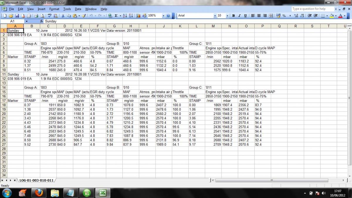

In sfarsit mi-a ajuns si mie interfata Vag Com 11.10 si azi am pus masina la test, fiind vorba de un Passat b5.5 2001 AVB 101 PD.De vreo 3 saptamani tot imi intra in limp mode daca depaseam 2800-3000 rpm.Debitmetrul l-am schimbat acum 6 luni de zile iar de 2 saptamani am schimbat si valva N75 cu una noua dar tot la fel face.Am facut si un log in mers in treapta a 3 .Tin sa precizez ca sunt incepator in folosirea Vag com-ului si interpretarea codurilor.
Sunday,10,June,2012,15:10:40:10074
VCDS Version: Beta 11.3.0
Data version: 20110801
Chassis Type: 3B - VW Passat B5
Scan: 01 02 03 08 15 16 17 19 35 36 37 46 47 55 56 57 58 75 76 77
VIN: WVWZZZ3BZ1P050894 Mileage: 215220km/133731miles
Address 01: Engine Labels: 038-906-019-AVB.lbl
Part No: 038 906 019 EA
Component: 1,9l R4 EDC 0000SG 1234
Coding: 00002
Shop #: WSC 00028
VCID: 5ABF965BE93B
WVWZZZ3BZ1P050894 VWZ7Z0Y2765861
1 Fault Found:
17965 - Charge Pressure Control: Positive Deviation
P1557 - 35-10 - - - Intermittent
Readiness: 0 0 X X X
Address 03: ABS Brakes Labels: 8D0-907-389.lbl
Part No: 8D0 907 389 D
Component: ABS/ESP front D46
Coding: 04255
Shop #: WSC 00028
VCID: 346318E32B1F
No fault code found.
Address 08: Auto HVAC Labels: 3Bx-907-044.lbl
Part No: 3B1 907 044 H
Component: CLIMATRONIC B5GP 0002
Coding: 17000
Shop #: WSC 00028
VCID: 2647F2ABEDC3
1 Fault Found:
00787 - Temperature Sensor in Fresh Air intake duct (G89)
30-00 - Open or Short to Plus
Address 15: Airbags Labels: 6Q0-909-605-VW5.lbl
Part No: 6Q0 909 605 B
Component: 0A AIRBAG VW5 04 0004
Coding: 12353
Shop #: WSC 00028
