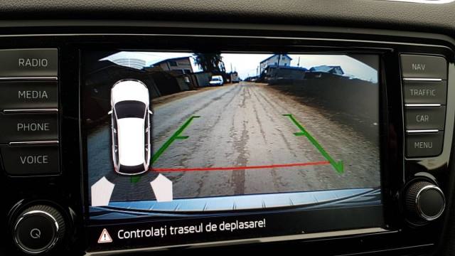

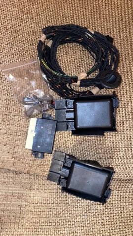

Acesta a fost primul retrofit realizat pe Octavia mea si anume instalarea BSD si RTA (blind spot detection si rear traffic alert)

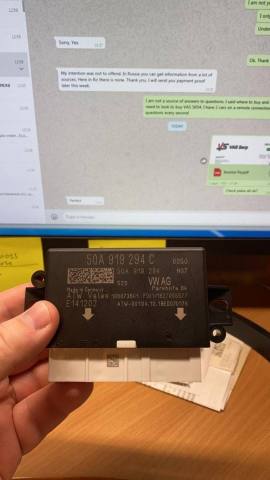

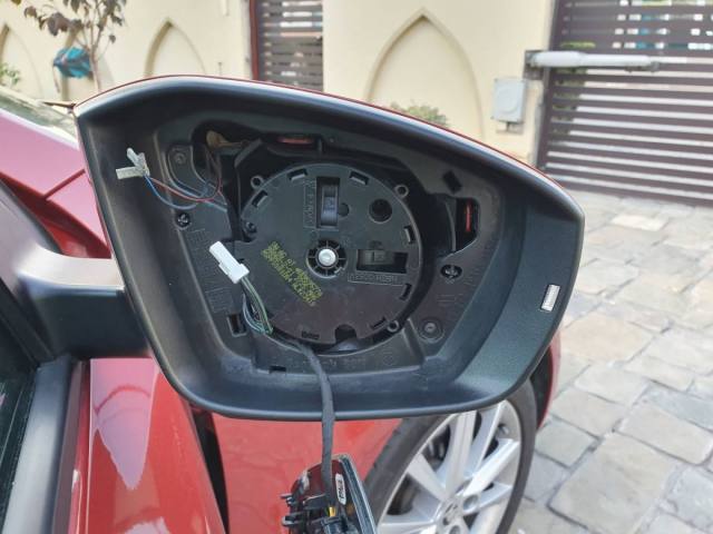

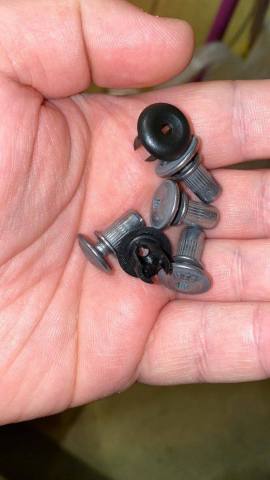

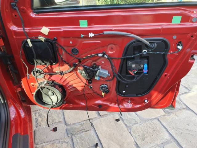

Am comandat cablaje,suporti,suruburi,nituri,radare. Radarele au venit gata parametrizate.
Modulul pt park assist a fost foarte usor de inlocuit (se afla sub volan) si codarea a fost relativ simpla.

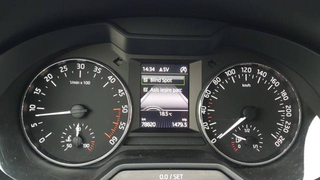

Codarile pentru Blind Spot Detection (BSD) / Rear Traffic Alert (RTA):
Block 19 Data bus diagnostic interface - Equipment list → note that 3C is installed - Lane change system.
Block 03 Brake system electronics - Closed area → Access code 40168 or 20103 → Coding → Long coding → Byte 29 → Bit 7 activate.
Block 17 Instrument cluster - Coding → Long coding →
Byte 5 → Bit 3 activate and Byte 11 → Bit 3 activate.

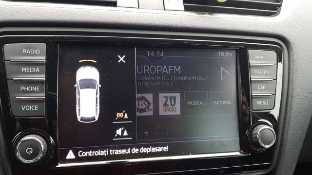

Block 76 Parking Assistant - Coding → Long Coding → Byte 3 → Bit 6 activate.
Block 5F: Informing Electronics - Closed Area → Code 20103 → Adaptation →
Car_Function_List_BAP_Gen2: SWA_0x1A: activate
Car_Function_List_BAP_Gen2-SWA_0x1A_msg_bus: CAN_Extended.
Car_Function_Adaptations_Gen2: menu_display_lane_assistant: activate
Car_Function_Adaptations_Gen2: menu_display_lane_assistant_over_threshold_high: activate

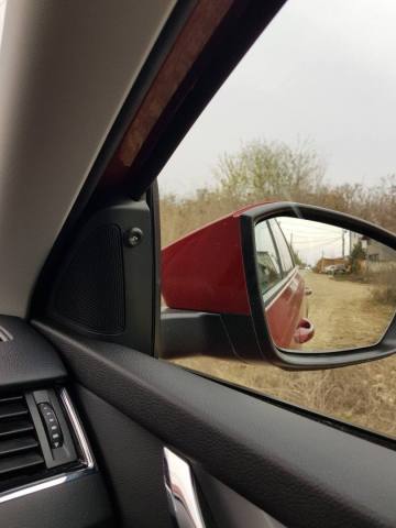

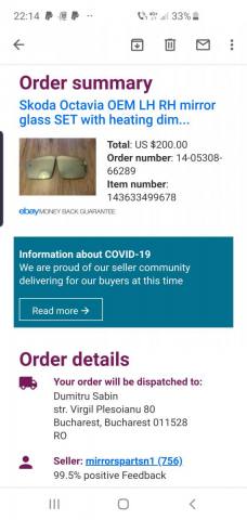

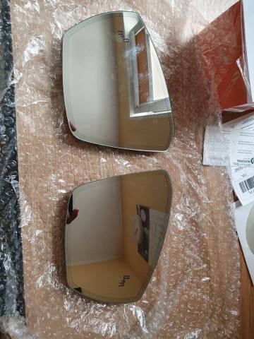

Un mic update. Am gasit oglinzile heliomate incalzite si cu indicatori BSD la un pret de nerefuzat. Sunt pe drum spre Romania :)
Modificat de sabinx

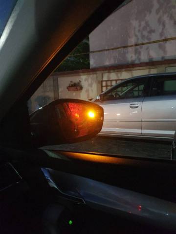

100% OEM finalizat!
