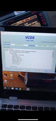

Dupa un drum pe autostrada mi-a aparut urmatoarea eroare pe modulul ACC :
Address 13: Auto Dist. Reg        Labels: None
   Part No SW: 3AA 907 567 A    HW: 3AA 907 567
   Component: AC201  RDW A    031 0170
   Revision: 00031000    Serial number: 00000000063944
   Coding: 0010000
   Shop #: WSC 00000 023 00000
   VCID: 3874C6134BC38DD8D95
1 Fault Found
00272 - Function Disabled due to Electromagnetic Interference
            012 - Electrical Fault in Circuit - MIL ON
             Freeze Frame:
                    Fault Status: 11101100
                    Fault Priority: 6
                    Fault Frequency: 1
                    Reset counter: 87
                    Mileage: 164735 km
                    Time Indication: 0
                    Date: 2006.14.17
                    Time: 21:01:58
             Freeze Frame:
                    Count: 51
insotita si de o eroare pe motor :
Address 01: Engine (J623-CFFB)       Labels: 03L-906-018-CFF.clb
   Part No SW: 03L 906 018 BG    HW: 03L 907 309 N
   Component: R4 2,0L EDC   H23 9936
   Revision: 41H23---    Serial number: VWZCZ000000000
   Coding: 001D0032047401080000
   Shop #: WSC 00046 000 00000
   ASAM Dataset: EV_ECM20TDI01103L906018BG 003008
   ROD: EV_ECM20TDI01103L906018BG.rod
   VCID: 70E43E33AB331598D15
1 Fault Found
4330 - Function Restriction due to Received Malfunction Value
          U1113 00 [039] - -
          Not Confirmed - Tested Since Memory Clear
             Freeze Frame:
                    Fault Status: 00000001
                    Fault Priority: 6
                    Fault Frequency: 1
                    Mileage: 164735 km
                    Date: 2006.14.17
                    Time: 21:00:47
Readiness: 0 0 0 0 1
Pe modul ACC am mai gasit urmatoarele coduri de eroare:
DTC 51542 - Failure mode 012
DTC 00272 - Failure mode 012
DTC 01492 - Failure mode 000
Se poate reseta cumva modulul ACC pentru a scapa de interferențele electromagnetice? Am scos siguranta nr.4 , am deblocat/ blocat ACC-ul folosind VCDS-ul, am upgradat firmware de la 0143 la 0170, dar eroarea persista. Eventual poate se poate activa temporar doar cruise controlul clasic temporar?

Acelasi lucru imi apare si mie:  00272 - Function Disabled due to Electromagnetic Interference 012 - Electrical Fault in Circuit - MIL ON.Opresc motorul ,pornesc din nou si totul e ok,dar pentru 5 km de rulaj,dupa aceeia apare in bord : ACC Error !Este vorba de un Passat CC 2009.Dupa cum se pare....nici un specialist pe aici!
Ti-am raspuns la celalalt post identic. Se poate incerca update de sw, daca exista pentru ce ai tu pe masina....sau inlocuire radar.

Salut, vin si eu cu o problema la acest topic. Masina este un Passat B7 Variant, an fabricatie 2012, cod motor CFFB, cutie DSG.
Joi seara cand am vrut sa pornesc masina m-am trezit cu eroarea "ACC : error". Am luat contactul, l-am pus iarasi si din nou eroarea. Am pornit motorul si colac peste pupaza a aparut imediat dupa si "Start/stop : error". Si asa imi face incepand de joi seara. Cu cateva zile inainte ACC-ul mi-a mai facut niste probleme, in sensul ca frana odata cu masina din fata si cand aceasta se misca, piscam usor acceleratia si nu mai voia sa plece, imi afisa pe MFD "Speed limit exceeded", cu toate ca viteza setata era 58km/h si practic ea trebuia sa plece de la 0. De cand a aparut problema Front Assist a disparut din meniul asistentilor din MFD, si martorul verde din bord pentru ACC a disparut.  Ca si verificari m-am uitat la siguranta 4 din panou si este ok, am verificat-o cu aparatul de masura si are continuitate. Am activat suplimentar si park-assist, ca e tot pe siguranta aia, si a pornit fara nici o eroare (doar ca nu am avut spatiu de manevra sa il pun sa si parcheze singur) - deci se exclude o lipsa de 12V pe ea.
Atasez si logul VCDS, poate ma puteti ajuta cu o sugestie. Seara faina !
Log-WVWZZZ3CZCE016022-302350km-302353.txt
verifica alimentarea radarului si firele de comuniucatie.
Ai putea te rog sa ma ajuți cu poziția lor ? Sunt cele din mufa din spatele farului stânga? Am mișcat aseară de toate mufele care erau la vedere și azi dimineață câteva secunde a funcționat după pornire, până a luat prima denivelare.
Sunt cele ce vin la radar.
