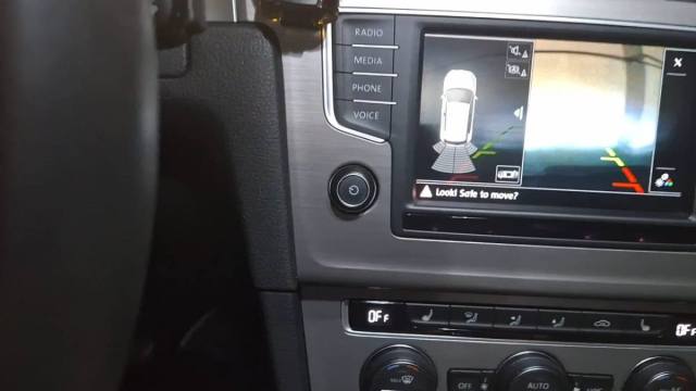

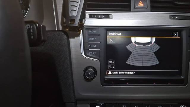

Salut
Am instalat provizoriu ( senzorii inca nu sunt in bara) PDC 4k si totusi senzorii nu masoara distanta.
Singurele module cu mesaje sunt:
Address 10: Park/Steer Assist (J446)       Labels: None
   Part No SW: 5QD 919 283 G    HW: 5QA 919 283
   Component: PDC 4 KanalH07 0050
   Serial number: 000308419919093 Dataset Number: V03935281RN 0001
   Coding: 0601150001
   Shop #: WSC 00156 758 00014
   ASAM Dataset: EV_EPHVA14AU3700000 009037
   ROD: EV_EPHVA14AU3700000_009_VW27.rod
   VCID: 51A9C04300E933191C-8004
No ASAM data for: "EV_EPHVA14AU3700000" (VW37)
No fault code found.
Address 17: Instruments (J285)       Labels:| 5G0-920-XXX-17.clb-SRI3
   Part No SW: 5G1 920 740 A    HW: 5G1 920 740 A
   Component: KOMBI         207 7652
   Coding: 07A51A002380000801083A001400000000000000 sau 90 cu bifa
   Shop #: WSC 01357 011 00200
   ASAM Dataset: EV_DashBoardJCIMQBAB 009005
   ROD: EV_DashBoardJCIMQBAB_009_VW37.rod
   VCID: 244759972FDBF6B187-8070
1 Fault Found:
13636608 - Control Module Incorrectly Coded
          U1014 00 [00001001] - -
          Confirmed - Tested Since Memory Clear
             Freeze Frame:
                    Fault Priority: 2
                    Fault Frequency: 2
                    Reset counter: 254
                    Mileage: 54293 km
                    Date: 2024.03.24
                    Time: 07:42:45
Am cautat in folderul VCDS\UDS_EV si nu am fisierul EV_EPHVA14AU3700000_009_VW37.rod care banuiesc ca imi lipseste.
Pe Display Infotainment totul arata minunat, fara semnalare erori. Se aude si beep-ul cand bag in marche-arrier.
Ce ma sfatuiti?
Instalezi corect, finalizezi montajul, dupa care vedem ce probleme sunt
  • 5 months later...
Salut
Am montat, nici o schimbare fata de postul din 2 aprilie.
Modulul "5QD 919 283 G" nu returneaza nici o eroare, modulul Instruments "5G1 920 740 A" returneaza eroarea din postul anterior iar pe ecran nu apar distantele masurate.
La cuplarea in marche-arierre se aude beepul initial apoi nu se mai aude niciun beep oricat m-as apropia de un obstacol.
Senzorii fac acele usoare pocnituri cand apropii degetul de ei.
Ce pot face?

Did you ever solve the problem? I have the same issue now after installation…
I used 5Q0919283G (second hand) instead of 5QD module.
