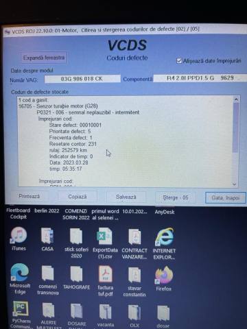

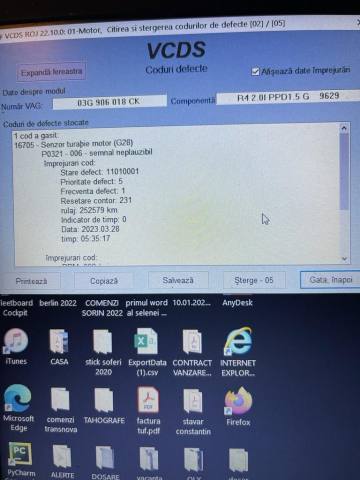

1 Fault Found:
16705 - Engine Speed Sensor (G28)
            P0321 - 006 - Implausible Signal - Intermittent
             Freeze Frame:
                    Fault Status: 00000001
                    Fault Priority: 5
                    Fault Frequency: 2
                    Reset counter: 119
                    Mileage: 377276 km
                    Time Indication: 0
                    Date: 2000.00.00
                    Time: 07:38:41
             Freeze Frame:
                    RPM: 160 /min
                    Text:      0    Nm
                    Speed: 0.0 km/h
                    Time: 0.00 s
                    Angle: 0.0 °
                    Bin. Bits: 00000000
                    Bin. Bits: 00000001
