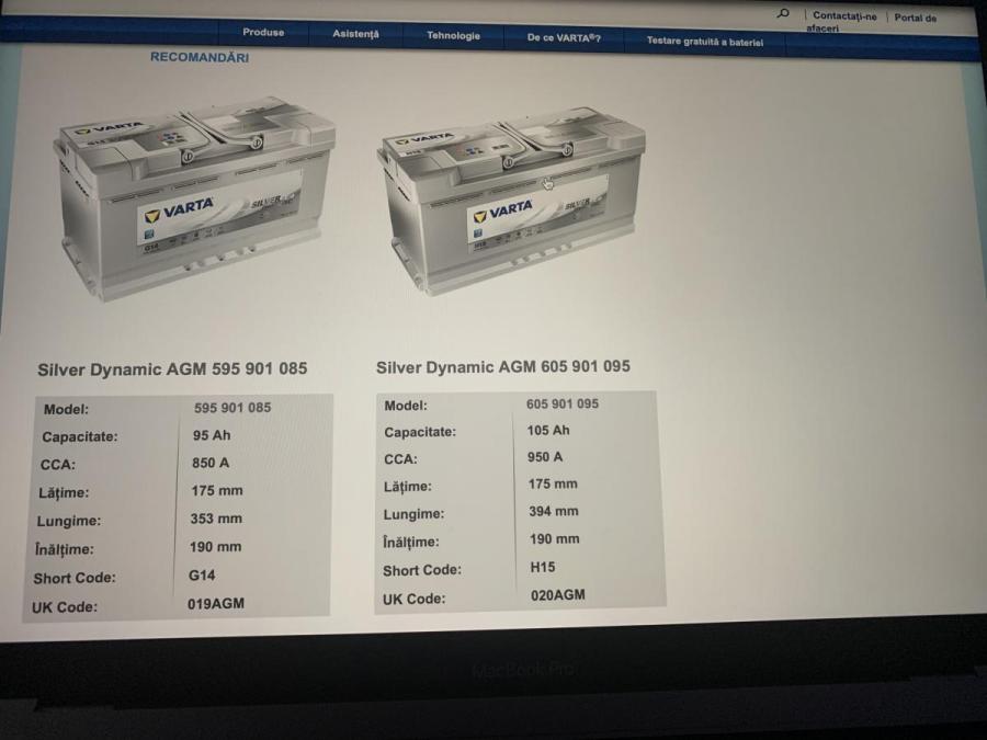

Cred ca a venit vremea sa schimb si eu bateria, cautand pe site-ul varta dupa modelul/motorizarea masinii am gasit aceste doua variante (atasat poza). A pus cineva varianta mai mare (105Ah/95A)? Poate confirma cineva ca una din ele sau ambele sunt perfect compatibile? Multumesc
Eu as merge pe Exide :
https://vrumauto.ro/baterii-auto/109468-acumulator-auto-exide-start-stop-agm-ek1050-12v-105ah-950aen.html
VW Touareg II - diesel engines:
3.0 V6 TDI - with the start-stop system
Bosch S5 AGM                             S5A 15              105 Ah     950 A             393x175x190 mm  B13
Exide AGM                                    EK1050             105 Ah     950 A             392x175x190 mm  B13
Varta Silver Dynamic AGM        H15                    105 Ah     950 A             393x175x190 mm  B13
Above versions VW Touareg they are equipped with a start-stop system and in this case we should use batteries in AGM technology. Dimensions of the suitable batteries vary a little for individual manufacturers and they are: 392x175x190 mm or 393x175x190 mm. The parameters of these batteries are the least 105 Ah capacity and 950 A cold test current. All batteries in the list above have the same capacity 105Ah and cold test current 950 A. All batteries in the list above have a bottom strip type B13.
Chiar preferam varianta de 950 dar nu eram convins ca se potriveste 100%. Probabil o sa merg atunci pe Exide, e si pretul f bun din ce am vazut pe site. Multumesc
